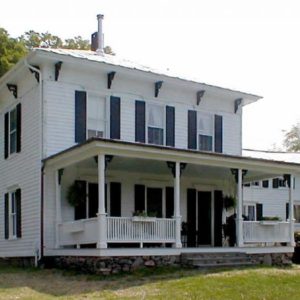

          mmoogie | Feb 15, 2009 06:59pm | #13
          I did a porch once where we built it 3" out of level for the 28' length of the porch. We started out tacking the ledger to the house level. The guy I was working for at the time could not bring himself to build it out of level until the homeowner came along and said how screwed up it looked. We then tacked the ledger on following the house and it looked fine.
            redoak | Feb 15, 2009 09:23pm | #20
            mmoogie,Yeah, the porch looks fine. I do think you've got to be flexible. Whatever looks the best, level or out of level.
