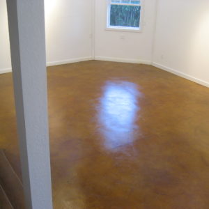

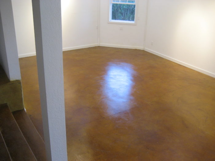

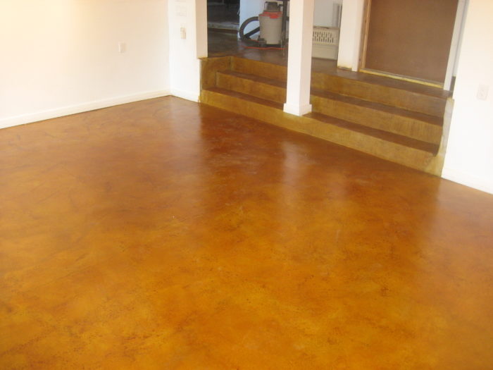

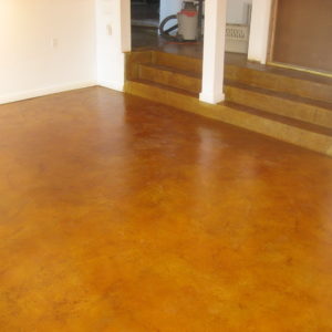

    Stain the concrete.
    Consider a concrete stain and sealer. Depending on the concrete, prep could be anywhere from zero to sanding with a floor sander. From your descripton I doubt if you'd need to grind it. Hairline cracks will just be part of the patina. Heat loss will be much more of a problem through the walls, since the floor is well below grade. You won't really loose heat through the floor, but you will be warming a lot of thermal mass. If you plan to keep the room heated this shouldn'd be an issue.
