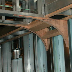

      JeffBuck | Feb 13, 2004 06:30am | #3
      I'd drop the drywall portion of the ceiling with steel joists ...
      try to frame every basement I can with steel walls ...
      and put in as much drop ceiling tile as I can to access everything ...
           Artistry in Carpentry

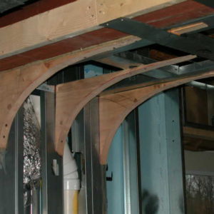

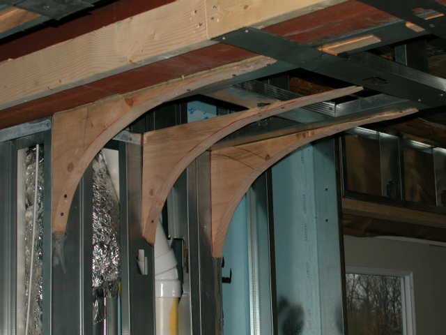

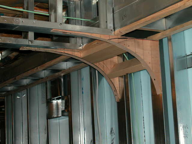

        JDRHI | Feb 13, 2004 07:49am | #4
        Nice work with the arches.....I was going to ask if you used plywood to frame them out...then I got to the third pic.

          JeffBuck | Feb 14, 2004 12:21am | #9
          I was gonna use one of those ...
          forget which one .. I see 2 regularily advertised ...
          called around and found my local 84 lumber could get them ...
          after I called the manufacturer ... got all the info ... sizes ... model numbers .. etc ...
          Then told the 84 lumber guy exactly whcih code to punch into his computer!
          Worked out to about $100 per arch .... but I was gonna order an arch 2' tall by 4 ' long and cut it in half  ... so I could make the 4' part spread across 7' ....
          so really $50/arch side ... now times 2 because my arches were a foot wide ...
          back to $100/arch side ... plus $40 delivery .. to 84 ... the  me do the actual pick up ...
          Started to get pricy pretty quick ...
          The clincher to site made came when the HO said he wasn't "exactly sure" of the dimensions he wanted ..... maybe 13 or 14 tall ..... maybe 24 or 26 wide ....
          So lumber it was!
          I've used ply and 2x blocking before ...
          had a coupla extra 2x12's laying around ....
          Decided it's 2x12's for the rest of my life! Real easy to cut... real easy to install.
          No more fighting and bending ply ....
          Where I wanted 3 across for extra drywall support .... I clamped all six ... three on each side..... together after the rough cut and just beltsanded them to perfection ....
          Lotsa glue ... coupla screws low ... coupla into the ceiling ....
          Done!

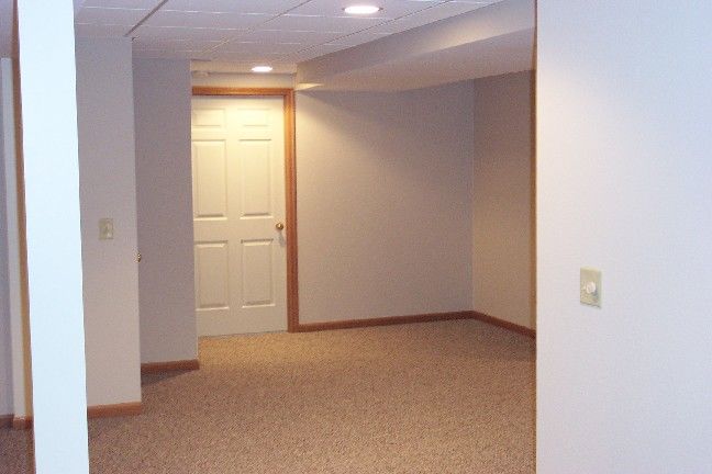

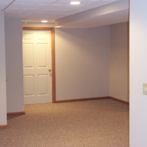

      2. CAGIV | Feb 13, 2004 08:01am | #5
        those tiles must have set ya back some. they look good though.
