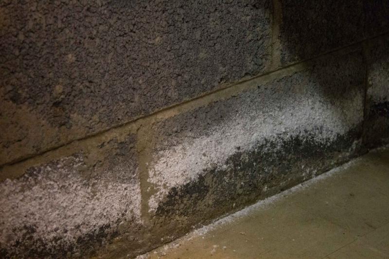

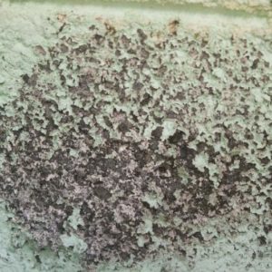

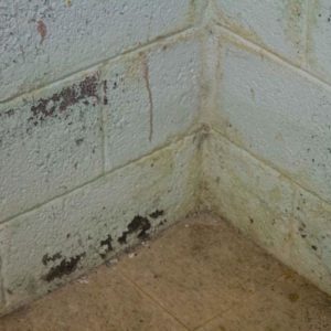

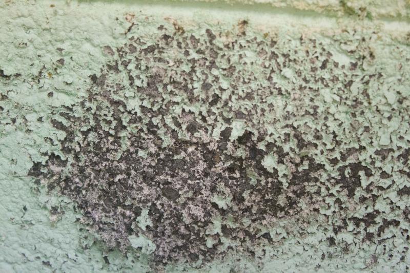

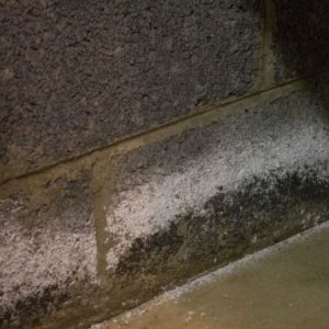

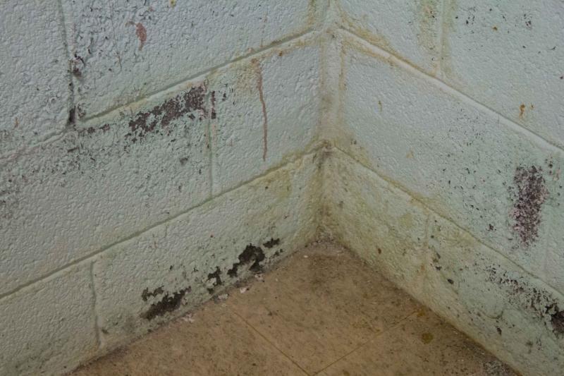

3.  There is efflorescence and water damage on the bottom of my foundation walls in the mechanical room.  I have attached a few pictures taken before I moved in.  The pictures with the black are parts of the wall that will crumble.  It’s not a large area but still i have concerns prior to insulating.  I have fixed a number of issues that have been a cause of previous water issues in the basement including the downspouts.  Before I insulate in this area, what kind of expert would you recommend to rectify these issues with the walls (unless this is something an intermediate DIY person can handle).

      Looks like you have a bit of moisture coming thouough the CMU block. Make sure the gutters are clear the leaders kick out water away from the foundation and that you are properly graded away from the house. That moisture will be trapped in your wall assembly...

    Personally, I wouldnt get too worked up about foaming them in place or caulking them in place.  You arent going to get any air leakage through the block (Rim joist area yes but none through the block).  So all the extra effort and mess with foaming in place is only being done for the minimal additional insulation value you will get.
