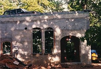

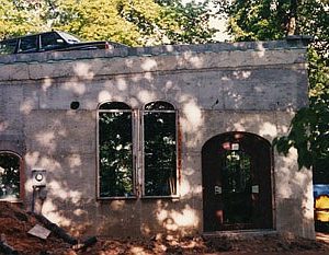

    Steel bar joists are going to be a very inexpensive method.  Topped with steel decking and a thin slab.  Depending on load and span, height can be as small as 10-12".  Here's my roof (30' span):
