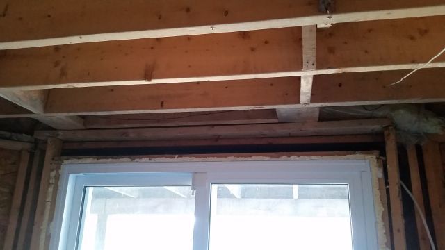

While demo-ing the interior walls of the basement, I of course pulled off the drywall around the walkout patio door.
This is where the fun started. It looks like they (home-owner 25+ years ago, who was also coincidentally a contractor of the builder) kept the double top plate above the door, but yanked out the studs and cut open the foundation without re-supporting the span (house goes up another 2 stories + roof + deck attached to the since-floating rim joist). Figured there’d be something to fix there as the bricks on the outside have always been in poor condition and the drywall always cracked on the inside above the door.
Anyways, I’m fixing it now. Since it’s open, I want to do it right, of course. I have included some photos and am pretty sure of what I am going to do, but wanted to get some other opinions as well so feel free to critisize/comment.
Here is the now:
Like I said, complete crap. They built the door into the basement by a 2×4 and tried to carry the weight back to their excuse of door framing and you may be able to notice the 2×4 sagging a bit.
