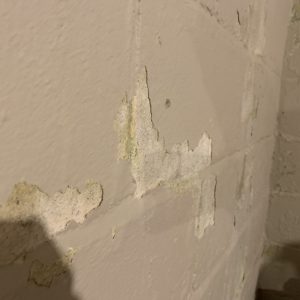

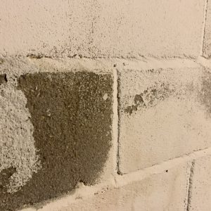

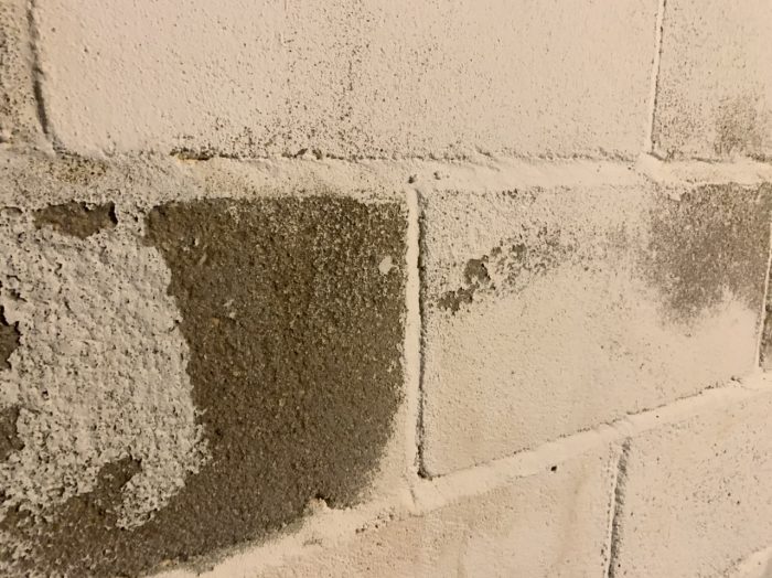

      I wanted to cover with paint just as an extra peace of mind. My walls are not wet and never saw water coming trough but I can see that In some spots there could be some condensation.
      I’m attaching a photo.
      I don’t want that some condensation would be trapped between the wall and the rigid foam.

      Have you seen the pictures I attached in the previews posts? Do you think the walls are good?
      I don’t know your name, in the meantime thank you for your explanations
      1. user-6819651 | Jan 06, 2020 11:10am | #14
        Your walls look a lot like mine did before I started and I had all the same concerns as you. What I did worked well for me. I primed any bare block with the Zinsser's before I started applying the first coat. From viewing the photos, everything looks fine to me. No moisture and no cracks or holes left to patch, I think your good to go. Dennis

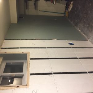

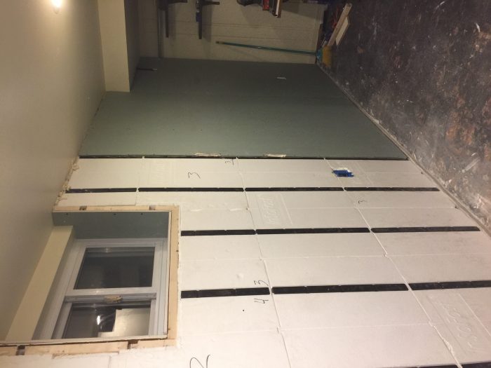

    I have used InSoFast insulation panels in several basements. They install quickly. No need for studs. Drywall attaches with adhesive and screws to the black plastic strips. Have to frame around window openings with wood. Highly recommend.

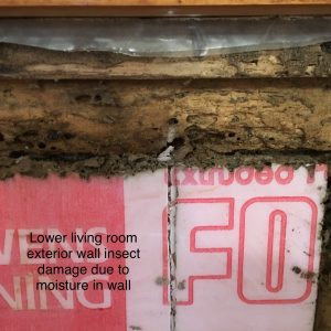

  10. x_navyfc | Jan 10, 2020 03:17pm | #27

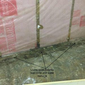

    My only advice would be to not do what the previous @!$&#*% owner did in my house. It was 2x2’s nailed onto cinderblocks with extruded polystyrene and plastic.
    Bugs burrowed the crap out of the insulation sheets and there was a ton of rot and damage.
    When I do eventually re-do it, I plan on using the rockwool sheets on top of the block with metal studs over that and rockwool batts in the cavities. Expensive but this is one thing that you want to have right the first time.
    1. angelods | Jan 11, 2020 07:59am | #29
      Wow, He really made a mess. The biggest mistake was using the plastic sheet on top that trapped any Vapor. I'm sorry. I can understand your feelings. I had to fix many mistakes from the previous owner in my house and still I have many to fix.
