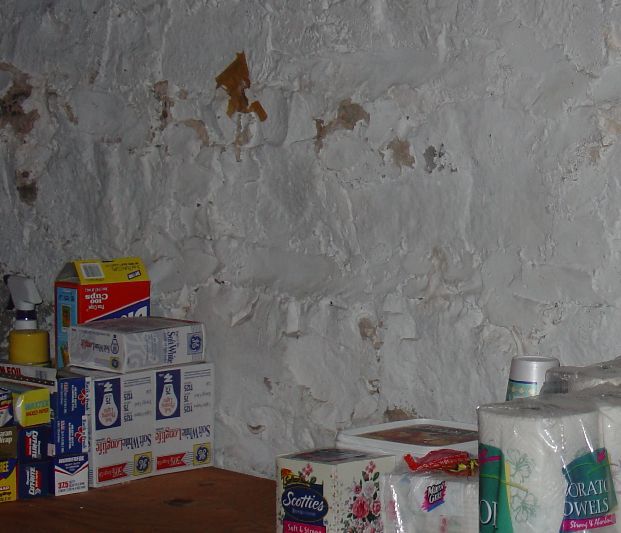

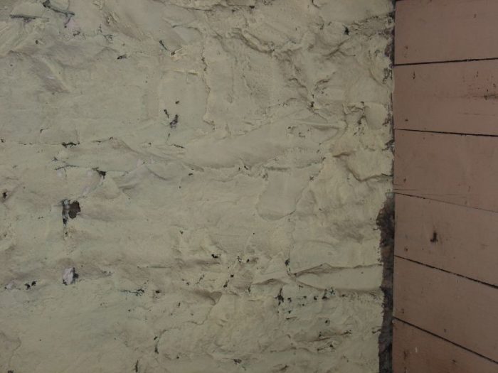

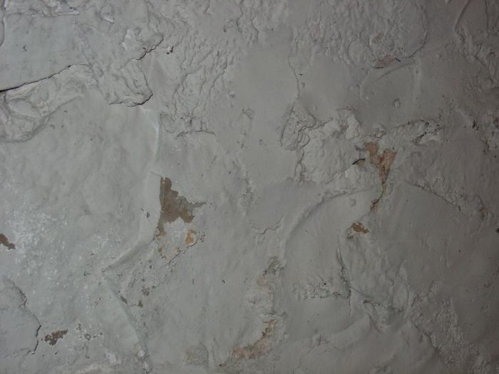

OK, these pics are of the basement walls in my Mom’s house in NE Wisconsin.  As best we can ascertain, the house is about 80 y/o.  A friend and I have been talking about these and it may be that these type of basement walls are called “rubble stone”…
Core issue is my Mom’s progressively declining health.  She’s been living alone and very independent for a long time and doing so is a point of pride for her.  So for first time ever, she is talking about selling the house (which is a blunt acknowledgement of her mortality and impending realities) and my sibs and I are looking at all the pragmatic issues.
We are not sure if the current state of the basement walls will scare away potential buyers.  That’s the impetus for this thread.  Whether to try and “fix” them (and how), or at the least, be able to tell potential buyers what the deal with them is.
Appreciate any comments, suggestions.  Hope the pics help show the disintegration of the “joint” material.  (I’ve tried to resize the jpgs to show detail without being too large for those on dial up.)  But it is crumbling and leaving piles of – well, like a…fine sand…and (non-rock) chunks of that original filler stuff…around the floor’s perimeter of the entire basement.
Oh yeah – years ago all the basement walls had fresh paint on them, and still have residual paint on 90% of the wall surface area.  But as you can see, that is not stopping the disintegration of the walls.
Also – after a 4 hour cleanup and inspection while I was there in December, there is no evidence of water leakage, or water stains, anywhere.

      looks to be high lime content mortar and time is taking it's toll...
      scrape  / dig out the loose and reparge / paint.... basically stucco the walls...
      add some white vinegar to the powder and if ya get a lot of fizzing activity there's a good chance that you got high lime content...
      best guess it's just out lived it's life... lotta elbow grease to fix is all...
        What is "reparge"?  (ok, I'm off to google shortly)
        OK, I did bring back some baggies of the filler stuff.  Just crushed and strained some, put in bowl, added undiluted white vinegar...not a "white" fizzing... but definitely it is bubbling.
        "outlived it's life" ?
         yowzah - are ya saying it is "failing" and walls/fdn in immediate need of fix?  I mean, this is the stuff that's holding it all together, after all...

          Again...best guess it's just out lived it's life... lotta elbow grease to fix is all... the core or what is under the top coat of loose flaking stuff should be fine... A new top coat should stablize the core and you'd be good to go fer another 100 years or so...
          the need of a fix is certain... when do we leave for this adventure???? Shall I stop at the El Rey store... the stuff is made right here in town...

    2. UncleDunc | Feb 05, 2005 08:54pm | #3
      No, this is the right folder. The main problem, and it's not really a very big problem, is expecting an answer in less than 49 minutes on a Saturday morning. This is, after all, the infamous morning after the night before.Do a search for the threads about jacking a house up and replacing the basement.

          If the high lime concrete is deteriorating over time and flaking off, then it seems to me that all cleaning and parging it will do is keep it from flaking off. It won't do anything to keep it from deteriorating. A basement wall that is visibly spalling is a problem you can keep an eye on and decide when to fix. A wall that is invisibly turning to cracker crumbs is a disaster waiting to happen.Maybe the deterioration is a result of some particular circumstance at the boundary between the contrete and the forms, and when all the bad stuff rots off they're will still be a permanent core of sound concrete. But I wouldn't bet the rent on it.
            IMERC | Feb 05, 2005 10:32pm | #9
            it's a mortored rubble foundation if I read her post correctly.....
            consider the spawling to be oxidation... the core should be good enough to stablize and coat over... I'm guessing at- from here - it's chemical bond break down...
            a pic with the overall wall would be nice...
            I shoulda asked if it was all of the wall that was spawling or just in places...

            I had a very similar situation in my home when purchased 15 years ago. The repair was labor intensive because the mortar joints were also failing. Just kept picking a small section at a time , chipped away and cleared joints, re-pointed and re-parged. Also ended up outside to improve drainage and gutters. All done by hand, in "spare" time, and so far so good. (14 years)
            Dinosaur | Feb 06, 2005 03:01am | #13
            From the pix she posted it does look like only the surface is disintigrating. The concrete holding the rubble together into a structural unit is unlikely to be the same mix as the mortar parged onto the surface once the forms were stripped. That high-lime parging mix was probably mixed that fat so it'd be nice and sticky. The concrete OTOH, 80 years ago, there's a good chance it's round aggregate mix, lots of quartz and granite pebble. No reason for that stuff to start dying anytime this side of eternity....
            I would find a couple of suitable spots to core drill and take samples to make sure the concrete is still in decent shape; if that's the case it's just like you first said: scrape and parge. A good stucco job would look nice on that; might bump the selling price too....

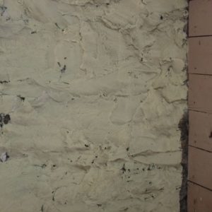

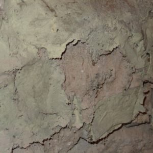

            Basement is about 9' vertically.  About 6 feet is below grade, rest is above.  In all the years of NE WI wicked winters, never had a leak from outside in via fdn or basement so suspect the core is still good.
            Getting  at the walls to apply shotcrete or the like?  Well, about 75% of the walls would have a clear shot at 'em.  In other places items like the water heater, furnace, etc., would make it difficult.  Right now, the exterior door to basement from outside backyard, is under quite a bit of snow...and that's the route to take to supply from.  (Doing something like that would be a bit wiser in a few months when the weather would support opening things up - doors, the windows to the basement, etc.)
            Is the house worth it (stabilizing the basement walls)?  I would say yes.  It was built back when woodwork included beautiful baseboards, crown, etc.  Leaded glass transoms, etc.  Roof is slate (still!)  Lifting house off fdn would be a bear due to the fireplace though... but then again, seems Piffin and others know how to get the job done from pics I ran across on this Forum so...who knows...if lift required, maybe could be done.

      2. mizshredder2 | Feb 05, 2005 09:18pm | #6

  2. DougU | Feb 06, 2005 05:54am | #18
    miz
    I have a house in Iowa, built in 1880's. It has a similar looking foundation. Mine is built with a local sandstone, it very soft, porous. You can carve it with a butter knife.
    I have piles of sand around the perimeter of the basement. I'm not all that worried yet, it started life about 26" thick and its down to about 24" now.
    I've had several masons, and local "experts" look at my basement. All of them told me roughly the same thing.
    The reason that my walls are deteriorating is because someone coated them with everything from plaster to several varieties of paint. The walls can not breath. Moisture is trapped in there and just as moisture is trapped behind siding, the paint will blister off. In my case the plaster, paint and whatever else has been applied over the last 125 years.
    I've owned the house for about 15 years now and I don't think that the chance of the house caving in is emanate but I'm guessing that I will have to address the issue some day. Just not going to do something foolish that will cause more problems.
    If your planing on selling the house you might just clean it up, you don't want to do something that is going to make it more difficult for the next owner. I don't know that parging the walls is the answer, the masons that I have had did not recommend any thing like that so I know for my self that I wouldn't do it.
    The pic's of the interior are nice, that will probably sell the house.
    Most people know that old basements are just that, old basements.
    Probably no help but I don't think the problem is sever.

    JeffBuck | Feb 06, 2005 09:01am | #19
    ok .. first off ...
    anyone talking and using phrases like ... "saving the house" ...
    is outta their mind.
    U got a little spalling of the block in the basement.
    It's nowhere near terms like ... "saving" ...
    it's like paint bubbling!
    scrape it and patch it.
    my parents belgium block basement had about 1/3 of the face of the block gone ...
    let'see ... it was 90 yrs old... and we fixed it when I was ... 12?
    and guess what? It's still standing.
    Old houses crumble ... no big deal.
    scrap all the loose stuff away. wire brush it by hand ...
    then decide.
    for just the surface ... drylock works good.
    For little more than surface ... drylock with a scoop of sand works good.
    U can also either parge with a mortar mix ... or straight portland cement mix from a bag.
    If there looks to be a reason to stabilize the block work first ...
    spray or brush slap on Acryl 60. That's a sealer.
    If U wanna seal and parge ... if it's a deep area when all said and done ...
    spray/brush in the Acryl 60 real heavy and sloppy .. then .... have a second set of hands ready with some nice fat portland ... spray .. trowel ... spray ... trowel.
    all the way down the wall.
    you walls look to be nothing.
    I'll take pics of the bricks we're gonna tackle soon. About 2/3rd of the brick face gone ... interior foundation walls ...
    and ya know what ... still no big deal.
    That house ain't gonna fall over either!
    people seemto think it's easy for an old house to fall over ...
    it's been there 100 years ... it'll take another 100 to push her over.

  4. Piffin | Feb 06, 2005 11:12pm | #35
    Haven't seen the rest of the thread yet, but here is my first two cents worth...
    those walls lok in good shape for the shape they're in. it is a rubble stone foundation. Back then, portland cement was uncommon. Lime based mortar was what they used. But lime is transient. Water in the ground moves through it and over a long enough time, fifty to a hundred and fifty years depending on lime content and water contact, the lime tends to wash away and leave mostly sand in the joints.
    From what I can see in the photos, the surface of the wall may have been patched before with mortar on the surface of the joints, and then a seal coat of either paint or Thorocrete or other masonry parging. If it were mine, i might do the same agian, by scraping any loose sand from joints, using a bonding agent and patching with portland mud and then using a slurry of Thorocrete to repaint/seal.
    But that might appear to potential buyers as though a "coverup" deal had been done. A local RE agent could comment better on that.
    The fact is though, that the walls are probably about 18" thick, and the exterior joints below ground are quite open and coming apart by now, ready to invite water in. I would leave that for the new owner to deal with, especially since new owners are 40$ likely to change things and add on anyway.

      1. mizshredder2 | Feb 13, 2005 01:15am | #60
        Just an update:
        Got some locals to look at the basement walls, got recipe for proper mix to use, got brother to agree to the job since his schedule has some openings in it.
        Work gets started next weekend.
