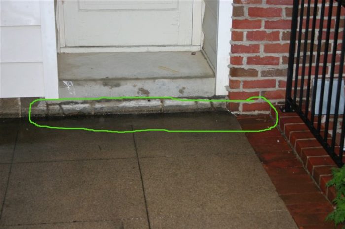

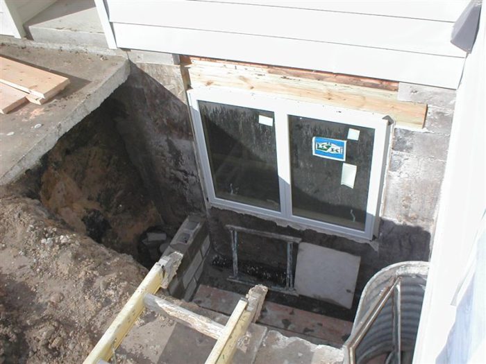

A few years ago we had an egress window put in the basement. A hole was cut in the patio to do this. (See BASEMENT EGRESS.JPG) We have recently noticed water trickling thru the wall in the basement just to the left of the window. (This would be below the door in PATIO 1.JPG) PATIO 5.JPG shows where the water is getting under the concrete, most of it by the brick. PATIO DRAINAGE.JPG shows approximately how the water flows by gravity on the patio. The downspout on the left goes into a clay pipe and I believe connects with the storm sewer or the tile line around the outside of the house. I can run water from a hose full blast into the downspout for 10 minutes and no water shows up in the basement.

1. Try to caulk/plug/patch the hole and cracks under the step. This seems to be where most of the water is getting in, but I suspect some is getting in around the brick that is around the window well and flower bed.
2. Tear up a portion of the patio and repour it to grade it away from the foundation and to seal the patio to the foundation.

Is that a footing drain tile I see under the window in Basement Egress.jpg?
Did you move the entry door in Patio1.jpg to the left from where it is in Basement Egress.jpg?

I too think Patio5.jpg is where the water is starting from.
If you do have drain tile at the footing I would give the water a real easy way to get to it. Take up the two paver bricks closest to the wall and drill a two" hole thrue the concrete under them. Center the hole on the joint between the two pavers and as close to the Railing base wall as you can.
Auger a 2" hole thru the backfill down to the footing drain and stick a piece of 1 1/2" PVC down it. Cut it off flush or just beneath the surface of the concrete.
When you replace the pavers, do NOT put any mortar on the ends next to the railing base, except to make a 45* ramp up against the house wall. Do not get any mortar in the PVC pipe. Fill the mortarless void with green kitchen scrubbies cut to fit the ramp and flush or barely below the surface of the pavers.

And, seal the whole patio where it meets the house.
