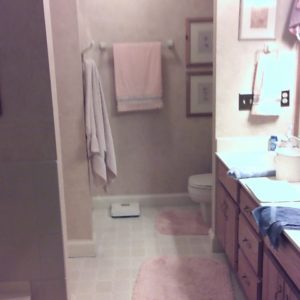

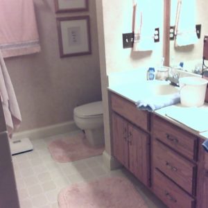

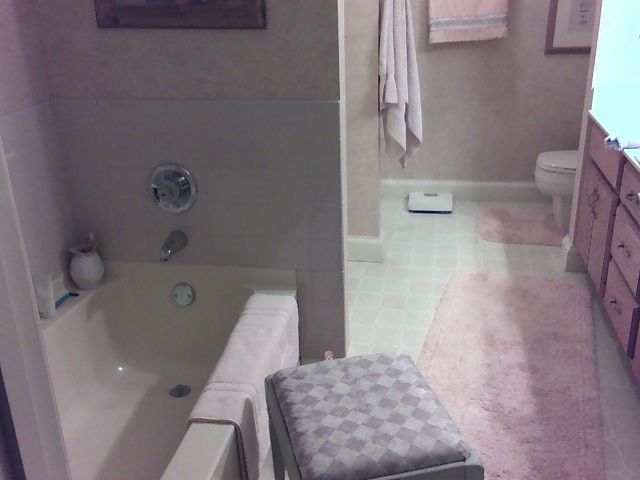

Some pics of a bath and closet project, FWIW.
Lots of cell captures, so the qual aint so great. Now that it’s coming down toward the end, I’ll get the camera out.
Theese are the befores.

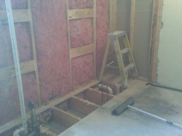

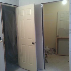

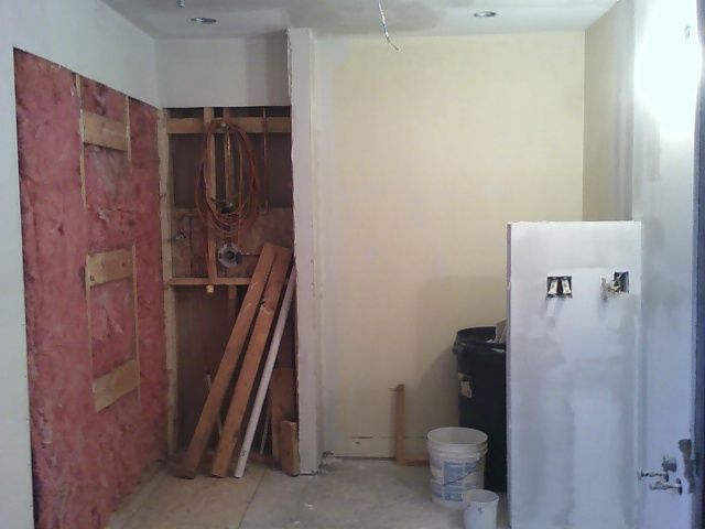

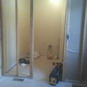

  1. JHOLE | Mar 01, 2008 07:06pm | #1

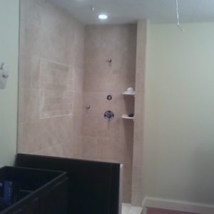

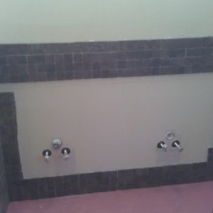

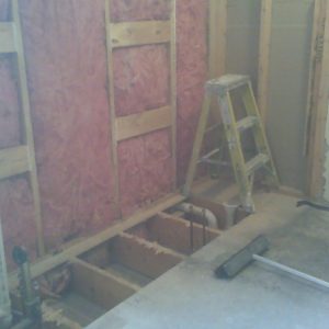

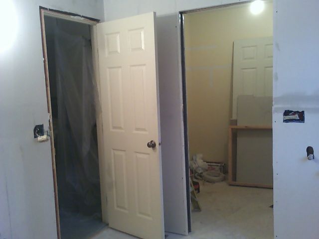

    After some demo and rough.
    Move tub feed from middle of room.
    Move shower feeds from middle of room.
    Cut fuul height wall to 1/2 height.
    Tear wall and install pocket to closet.
    Reframe vanity wall for recessed med cabs.

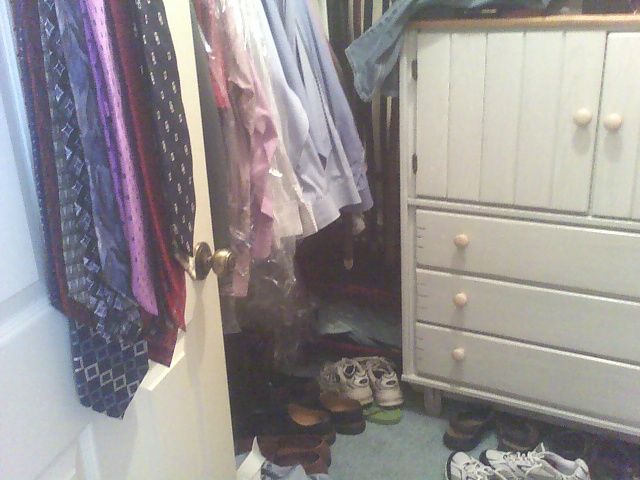

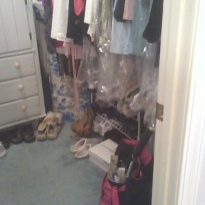

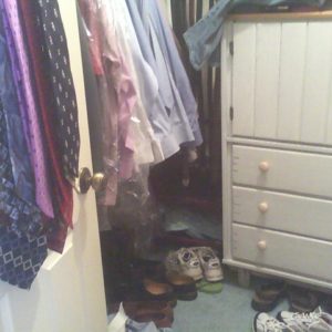

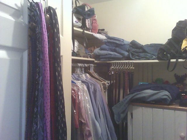

      Forgot closet befores.Remodeling Contractor just on the other side of the Glass City

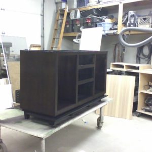

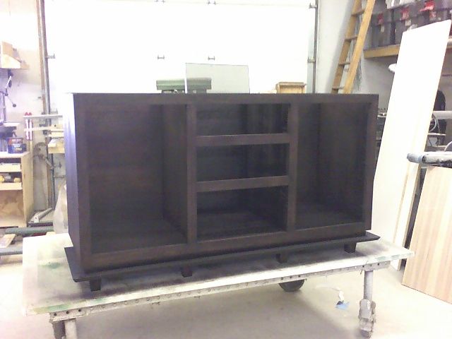

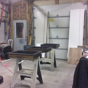

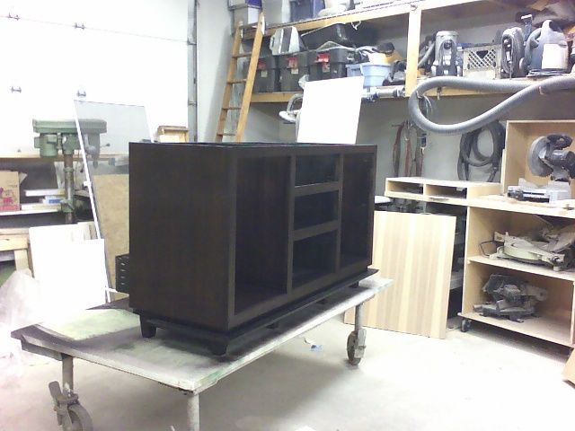

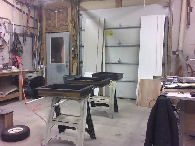

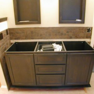

          Time to start bath cabs.
          Lots of goofyness. Undermount, softclose slides and doors, haven't used them up 'til now. Not hard, just different.
          Vanity also has a integral shelf to support granite " skirt " to be added so that the vanity will appear to set on a granite slab. Doesn't really show in these pics yet.Remodeling Contractor just on the other side of the Glass City

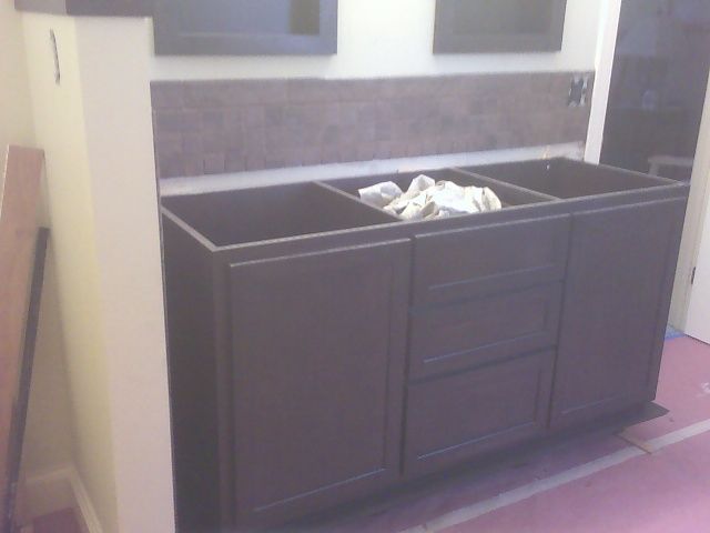

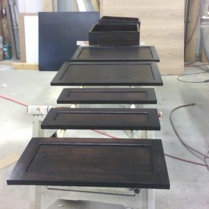

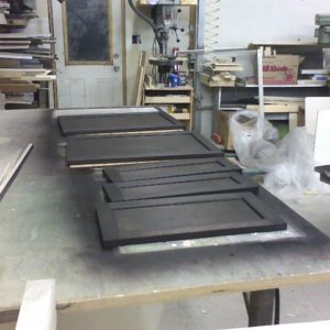

          5. JHOLE | Mar 01, 2008 08:52pm | #10
            Whiner.

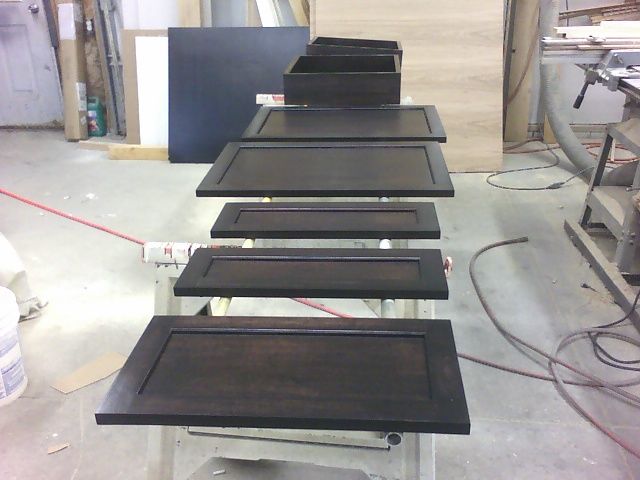

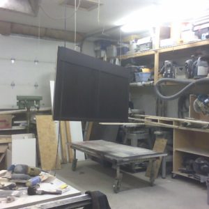

            On to finishing, a real biatch. Ended up with hickory ply and poplar sticks to build the cab out of. Don't ask. Ho was real funny about the vertical grain and I went through endless samples to get an approval.
            When it came down to staining the assemblies, it was alot of hand rubbing to get everything to blend.
            Came out better than we could have hoped for though.Remodeling Contractor just on the other side of the Glass City

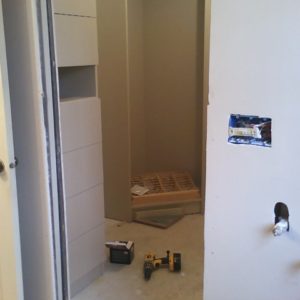

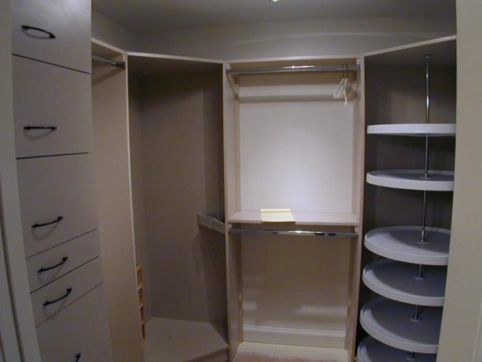

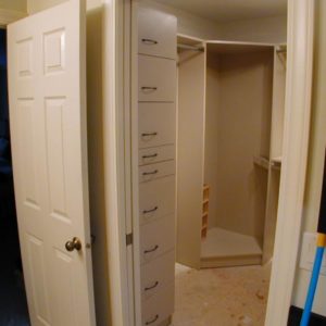

          6. JHOLE | Mar 01, 2008 09:09pm | #11

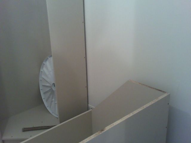

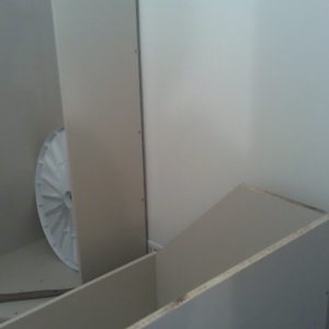

            Start to assemble the closet.
            Pics suck. It is 8' x 7' room off of the bath. Had to disassemble the two large corner cabs, and reassemble them in the room - 30"x30"x7' cabs. It was a tight fit to say the least.
            As you look into the room - on the back right corner isa six level, 7 foot x 28" lazy susan for her shoes. On the back left corner is the same rough cab that will house his pull out tie rack, and a trouser "carousel" which i should be welding instead of typing this. On the near right corner is a 4" wide cab with pull outs for belts, scarves, and other thin items. The near left corner is the "pantry", with four drawers down, three pullouts up (basically three sided drawers) to make a pull out shelf, and two thin jewelery drawers in the middle.
            The balance of the room is shelf and rod combos.Remodeling Contractor just on the other side of the Glass City
          7. JHOLE | Mar 01, 2008 09:19pm | #12

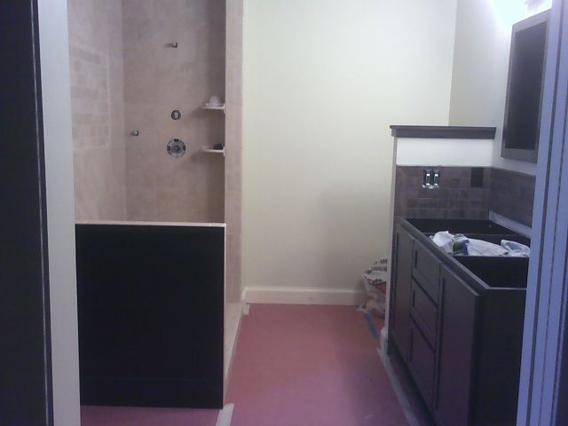

            Some progress pics.Remodeling Contractor just on the other side of the Glass City

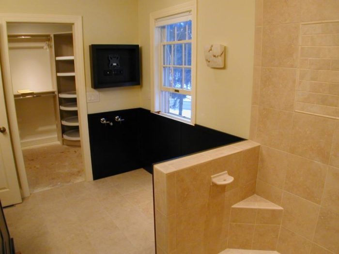

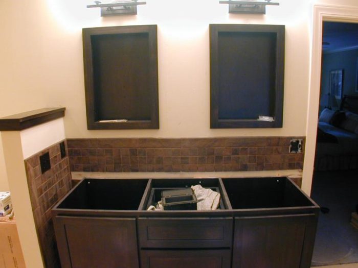

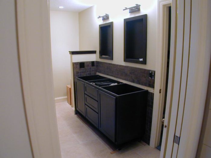

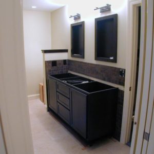

          8. JHOLE | Mar 01, 2008 09:38pm | #13

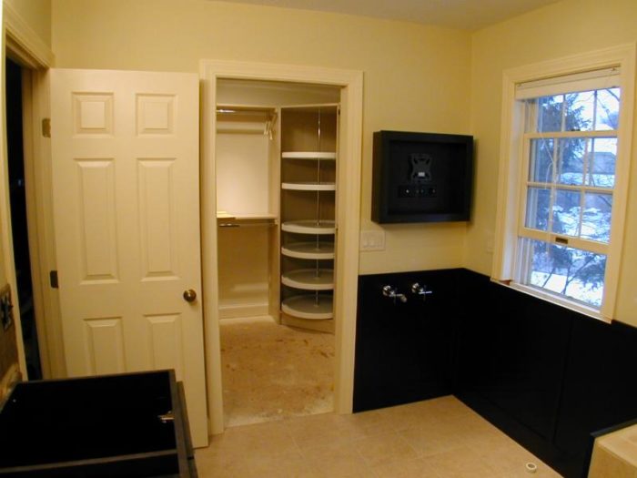

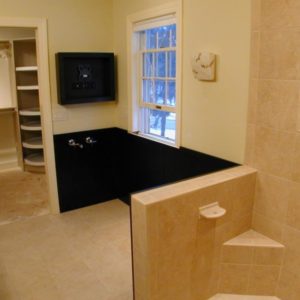

            Yesterday's pics, getting close.Remodeling Contractor just on the other side of the Glass City
          9. JLazaro317 | Mar 01, 2008 11:12pm | #14
            Whiner?
            Ho.

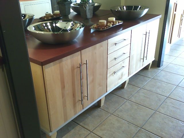

            Looks nice. Why the two different woods. I can't tell by the pics, is the grain visible? Is that paint or stain? I thought I saw primer in a prior pic. I like the vanity hung on the wall.
            Shoe carousel.....he/she must have a shoe fetish. I've never seen it before. That is a novel idea that I'll have to remember. I like the metal closet rod. Works much better than wood. We use fence top rail. Fits in the pole socket, doesn't sag, and hangers slide well. Doesn't look as nice as yours but we've done it that way as long as I can remember. I hate wooden closet pole.John

          10. JHOLE | Mar 02, 2008 02:17am | #15
            Hopin' you'd come back after makin' me finish.
            I'll take back the whiner thing now that you followed up.
            The "main" grain of the wood ends up being pretty obscure, and tends to just give a subtle variation through the finish, to give the feel of real wood vs. paint. The vertical grain lends some texture to complete the natural feel, and she wanted it as tight as she could get - and I had to be able to actually buy the stuff. I tried every combination I could think of that was somewhat available. ( I had suppliers scratching their own heads ). I have lost some sleep over pulling this off - it is coming together and everyone is pretty damn happy (finger crossed).
            Vanity is not hung on the wall - it's a "free standing" variety. Pic enclosed is what I was told to go emulate. Except for the color, shape, size, door style, depth, heighth, width, trim, and "add granite to the bottom".
            She has ALOT of shoes. Never seen it either, pulled it outa my butt, trying to make a 8x7 closet functional, utilitarian, dynamic, and eyecathing. Probably screwed up somewhere. Just waiting for it.Remodeling Contractor just on the other side of the Glass City

          14. ravz | Mar 03, 2008 11:18pm | #19
            Is there going to be a door on the shoe-susan?  im hoping for a curved front :)
          15. JHOLE | Mar 04, 2008 04:48am | #21
            Budget is getting alittle run-away.
            not planning on a door. I'll make it if that's what they want.Remodeling Contractor just on the other side of the Glass City

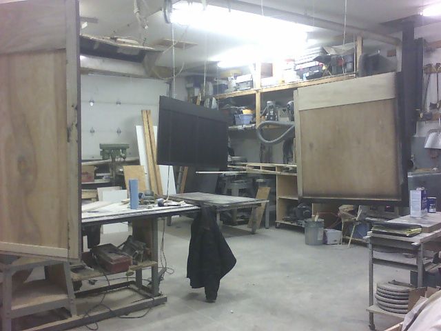

            larryscabnuts | Mar 04, 2008 02:27am | #20
            Pictures of your shop makes me lust for the past when I spent many hours working in mine. I miss my old shop. <sniff> OBTW you do very good work.
            Edited 3/3/2008 6:28 pm ET by larryscabnuts
          17. JHOLE | Mar 04, 2008 04:53am | #22
            It aint no cabinet shop.
            But it's home.
            I do ok work, I seem to always be be trying to do the next thing that I may not be qualified to do by leaning on what I do well and stretching the boundries of what I can pull off.
            But I appreciate the encouragement.Remodeling Contractor just on the other side of the Glass City

          19. DougU | Mar 04, 2008 07:41am | #24
            JH
            I like that shoe carousel as well, clever idea!
          20. DougU | Mar 01, 2008 08:44pm | #9
            JH
            I really like your roll around work benches.
            Keep the pictures coming.
