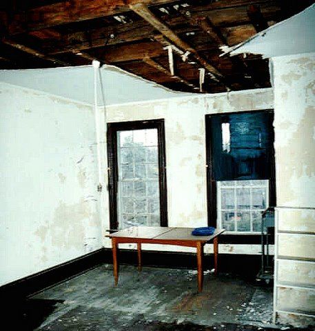

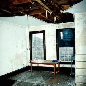

      McDesign | Jun 17, 2008 12:36pm | #15
      Forgot to attach a pic - the chimney is on the right; fireplace faces left.
      Just needs some paint.

      1. seeyou | Jun 17, 2008 12:55pm | #16
        Got any "before" pix?http://grantlogan.net
