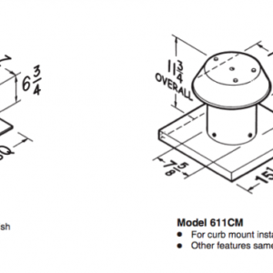

I need to replace my bathroom roof vent, it was installed wrong before I owned the house. After doing research on this site a few people recommended Broan. I am looking at this model http://www.broan.com/display/router.asp?ProductID=2925. I am concerned that it does not have much height for a snow cover, (I’m in North Jersey). My roof is a 12/2. Will this model be OK or does anyone have any other recommendations ?

    model 611 is for low slope roofs

      Sorry about that, its 2/12. Low slope. will that model still work?
      1. MikeSmith | Jul 20, 2009 03:50pm | #8
        as  doodabug  pointed  out  the  #611  is  for  flat  to  low  slope
        you  may  or  may  not  have  to  build  a  curb  to  mount  it  on
        i  think  you  can   download  the  instruction  sheetMike Hussein Smith Rhode Island : Design / Build / Repair / Restore
        1. Sbds | Jul 20, 2009 03:59pm | #9
          Thanks Mike,
          They have a model 611cm for curb monut. Which one do you think I should use?
          1. MikeSmith | Jul 20, 2009 09:51pm | #10
            i'd  build  a curb  and  bring my flashing  up  to  the  top  , then  use  the  (CM)  flanged  model down  over  the  curbMike Hussein Smith Rhode Island : Design / Build / Repair / Restore
