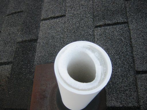

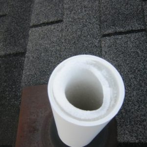

        BTW, the waste vents not only vent sewer gases, but (more importantly, perhaps?) equalize pressures in the waste kines so a slug of water draining down a waste pipe doesn't poll a vacuum behind it and suck water ouit of the traps.
        BTW/FWIW, attached is a pic from a couple of weeks ago of frost trying to seal off a vent at the top.  This was taken after a week or so of temps well below freezing and close to 0 at times in NW Ohio_______________________
