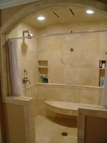

Thinking about doing a design on our “future” shower enclosure. Want to know if 3/8″ tempered glass can be bead-blasted or etched after the glass has been tempered? Will be templating this week for two side panels and a center door to be manufactured (see pic). If I choose to put a design on these pieces later, will they explode on me? will I deplete the integrity of the units? or is this commonly done after tempering? Any feedback will be greatly appreciated!

    That shower  curtain does look a bit tackey on the Taj Mahal.
