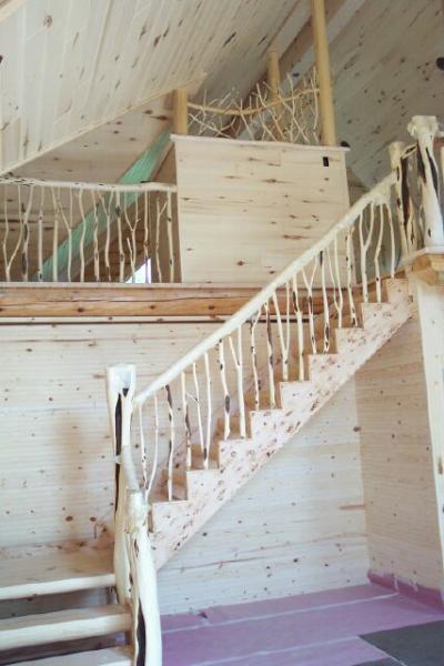

It started out as a sort of hum-ho regular set of stairs employing my usual polished components. About midstream through the design process the customer decides his log home needs a more rustic version and sends me an e-mail instructing us to build a set that would make a beaver proud. I almost hurled at the thought of having to resort to prehistoric stair building. As a compromise I merged my captured bark rustic stringer with hand peeled Diamond Willow newels, railing and twig balusters, stopping just short of using mud and grass for putty.
Surprisingly enough once I got started the project turned out to be a lot of fun. Since the ways of the beaver was foreign to me I enlisted the help of Fred, a friend of mine who builds rustic furniture with an artistic flare. Fred concentrated on dragging the material out of the bug-infested swamps while I labored in the climate-controlled environment of my shop building the structural components. Fred lost so much blood from the mosquitoes that his eves cleared and for a moment I though he might turn into a republican, turns out this was not to be the case.

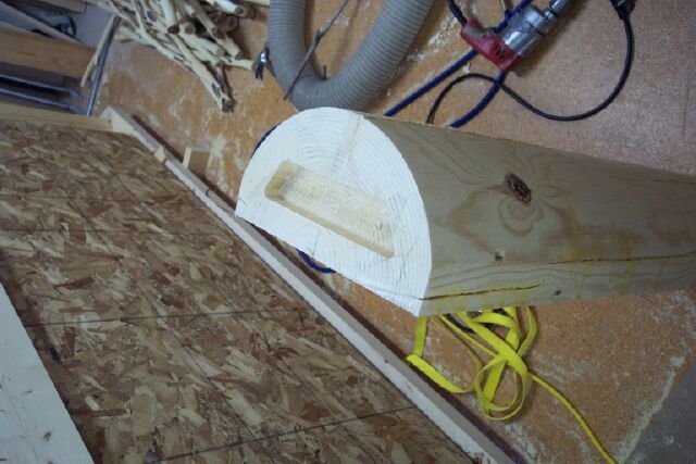

The biggest can of worms was dealing with the shrinkage problem since the treads were only dried down to 20% mc. I opted for using a floating tennon connection between the stringer and log tread, going with the assumption that as the log shrinks it will tighten itself around the tennon and remain firmly locked in place thus eliminating the customary loose stair tread scenario. Photo below shows tread tennon mortise.

The stairs do pass code, the balusters were layed out to meet the 4" sphere requirements, took time and a large assortment of twigs. The log treads also pass the 4" rule so risers are not needed. The big headache was finding a stair rail of the right diameter. The first one is still in the woods, didn't see the hornets nest until it was to late, decided against relocating them, or debating ownership rights.

Do those spindles meet code? LOL!
Armin, is that Cruella de Ville's house?
Armin- You get all the fun jobs. How is it you get all these very unique jobs? There must not be a 4" spacing rule on your balusters. Your beaver left some of the bark on that rail cap.
Excellent work!
I really like the mortise work you did on the treads.
Looks like a very labor intensive job.
He doesn't need to worry about somebody saying, "Hey, that balluster doesn't look straight!"
Yup, the upside of the beaver job, no level required.
How is it you get all these very unique jobs,
It helps to be eccentric.
It passed the 4" beaver head rule.
Part of the tree had died off leaving the bark firmly fused to the log, once the oil finish is applied it will turn a nice redish brown, gives it character.
