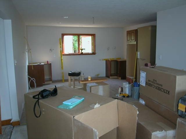

started the Tues after Labor Day. Agree to help a buddy till that Fri when I was to start a “kitchen blitz” … working straight thru … 3 kitchens with lotsa vanities … till I got into the third on the list ready for the tile guys. Today was dump day for that last demo. Got it all in … only to find the tile guys can’t start till Monday and will be 3 instead of 2 days. But I don’t care … 17 10+ hr days … I’m just glad to have a light day tomorow and an extra long weekend off!

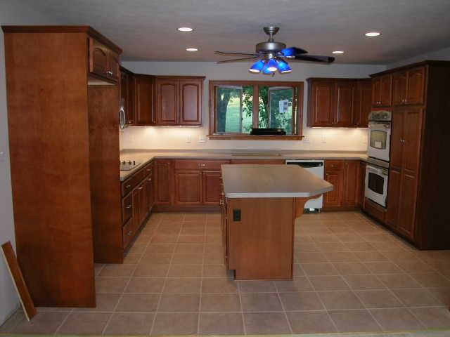

didn’t get picks yet of the very first kitchen … way cool … Poggen Pohl Cab’s.

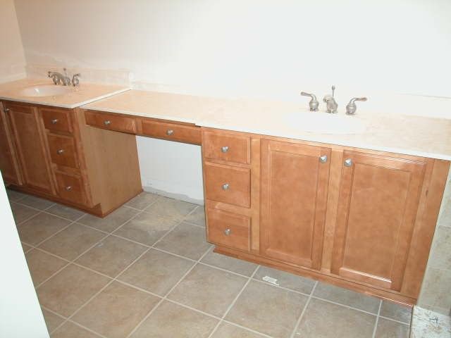

but got the rest …View Image

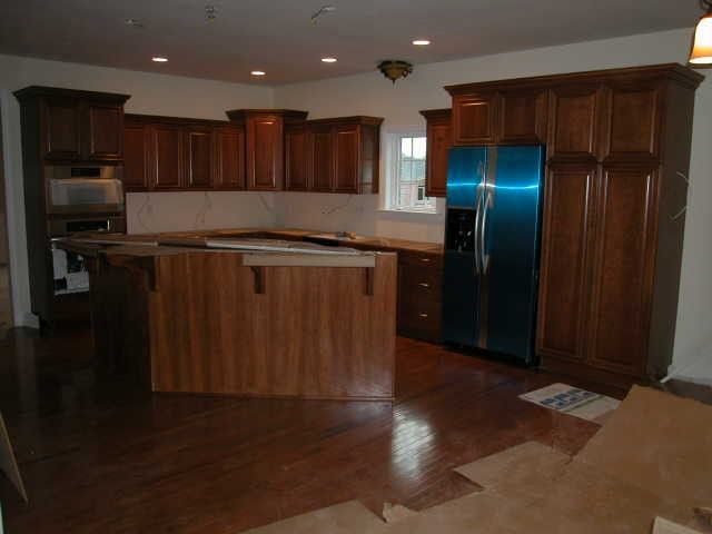

and more ...

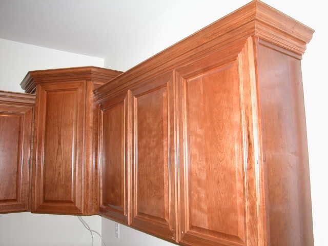

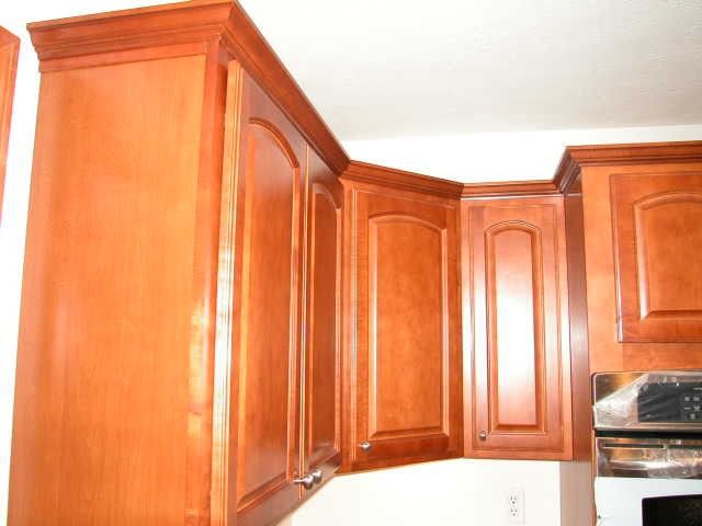

Also, I've got a kitchen where cabinets were kept down from the cieling about 3 inches, now crown is to be added between cabs and cieling (tile on firring strips). Any ideas on how to fasten the crown without taking down the uppers and putting nailers in?
Don K.
this particular brand of cabinet doesn't have alot of meat above the doors ... so as habit I add a strip of 3/4 ply by what ever ... usually 1 1/2 inch ... on top of the face frames as a nailing backer.
I catch the cab face frames by a fat 8th and nail into the side of the ply.
I'd suggest the same for yours ... with 3 inchs or so to fill ... I might be tempted to go with 2x stock ... when there's room .. I staple down thru the top of the ply and into the face frame ...
in your case .. existing cabs .. I'd probably try to either glue and shhot the 2x or screw thru the top "inner edge" of the cab's to secure the backer ... then attach as per the norm.
when my 23g pin nailer .. I like to pre-assemble the crown as much as possible ... glue and pin ... then let it set a coupla 15 minutes or so ... then tack into place as a unit.
Kinda stinks when ya miss something and gotta trim an 8th off a whole 3 or 4 section of crown ... but usually worth it in the end.
Jeff Buck Construction
Jeff-
Thanks for the idea. Don't know why I didn't think of that. I kept on thinking of how I can get down from the top (an obvious impossibility without removing cabinets), and never turned upside down and thought about coming up from the inside bottom.
Don

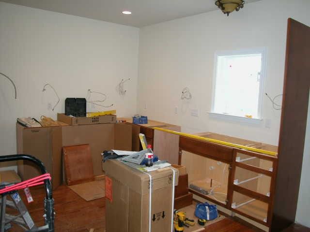

Can u tell me some about the wiring to the lighting under the cabinets? I'm about to rip out our old kitchen and want to put up what I had built. Which do u do first the wiring, wallboard then cabinets? Or after the cabinets are up?
Jeffs probably all tucked in now but I can help--With open stud bays lay out your kitchen close but doesn't have to be exact,tack wire ends to the studs above the bottom of your uppers. (reason to follow) couple of inches is enough.rock, tape, prime, ready for cabinets,When hanging the uppers, with your level line across the bottoms , Channel out the dw down to the line and bore a hole in the under hollow of the uppers--usually 5/8 for 1 wire and 3/4 for two. Hang cabinet with top against the wall and bottom out some--feed the wire thru and slide cab against the wall, secure with screws and move on---Course ya asked Jeff this question so he might tell you I am crazy--don't listen to him---I haven't heard the voices in almost three weeks. <G>
Mike" I reject your reality and substitute my own"
Adam Savage---Mythbusters
Mike said it.
run the wires before drywall. Poke them out about the bottom of the cabs.
do the layout ... mark your bottom level line ... cut/hammer/rip thru a 1/4 or so above that lower level line ... I like to make the hole a little bigger so they fold back into the wall easier.
then .. drill the hole thru the rear bottom rail ... stick and pull.
if you are working one handed ... build a 2x box support to rest the cab on while U slide it into place.
size it to either set on the floor for uppers first ... on the bottom cab boxes .. or on the counter top.
