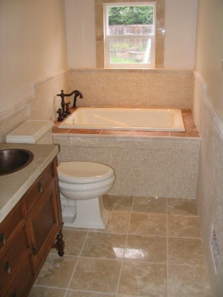

Nice. Is that window casing tile?
Yes, thx. All travertine.
Excellent. I love doing bathrooms because they look so great when done.
Just for curiosity, what use is a bathtub that small. I'm a bath person, not a shower person so I'm kinda curious.
I know.................I'd use it as bidet.............if it had some hand holds........................maybe:)
roger
Good question...
These folks have another small bath with a shower upstairs they use as their primary. The down bath they wanted as more a 'retreat' and so the pretty little deck mounted tub, which I had to actually bump out the end wall a foot to do.
The tub is Kohler's "The Greek." It's 4' but almost 2' deep.

Do you have any 'during' pictures? I'm going to be installing a drop in tub in the future and have been scratching my head a bit. Even tighter than that one. The tub is only about 1/2-1" narrower than the space it needs to go into.
My advice to you is not to inquire why or whither, but just enjoy your ice cream while it's on your plate-- Thornton Wilder
I might have a couple, but I could just as easily explain the inevitable glitches that arose with the tub part of the project!
(I'm beginning to assume that even the 'finest' project by the 'best' craftsman has several 'glitch' experiences involving hacking something with a framing hammer and chisel... What do you think? That would be a good thread.. 'hacking your way to beauty and function...')
SO--I did not have the tub when I built and tiled the deck/box but went by the specs and drawings I got off kohler's website. Instr show setting tub on deck and then tiling up to it but I thought that was stupid so I tiled first and set the tub on the tile.
Depth to surface of deck was specified also but why bother with that when you're going to set the tub down in mortar anyway, so I went about 2" high with the deck and splooged it down into themortar sweet and level on the deck. Then siliconed around. It's not going anywere.
You say you don't have much room around your rim? Where's the filler going? In the wall? This is where I ran into a hair of trouble. The deck was flush with the framing on the tub filler side which didn't leave any clearance for the overflow. Had to hog out for that. Not a big deal, but look out, especially in your case. The overflow on this tub was actually proud of the rim by 1/2" so there had to be room for it right under the deck with rim above.
Then you have access to hook up the drain? It wasn't a problem for me to get under the house and connect.
Which tub do you have and do you have the specs for it?

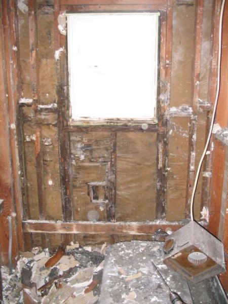

Hey, you primered the studs in the tub wall. What was the reason for that?Somewhere between nowhere and goodbye
LOL, someone asks me about that every time I post a pic. The house had a mold problem, so i followed the IDPH guidelines for cleanup. Scrubbed with a detergent and then sprayed with a bleach mixture. To that I added my own step: paint it with anti-mold exterior paint. That not only gave me peace of mind that the mold wouldn't come back, but it let me know where I'd scrubbed/sprayed and where I hadn't. The non-white studs are the ones that went in after the mold treatment.jt8

Is that a four foot tub? We put one in that looked about that size last year.
Edited 5/30/2008 9:04 pm ET by MSA1
YEah,
"The Greek"
Kohler.
4' and 23" deep.

Very nice job, particularly the vanity and the window trim. I get really tired of seeing wood casings where tile and stone would be better, so I'm glad you opted for that. Like the tub, too.
Good, classy job!!
Thanks,
Appreciate it. I was lucky enough (done enough other work for) this couple that they let me go 'carte blanche' on their bath and do what I wanted.
