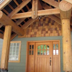

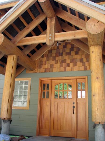

Was stapling sidewall shingles in our entry yesterday and must have dropped the effin’ gun about 15 times. Too much fumbling with shingles, level, hammer, etc…Dented the door, broke the hose extension…major frustration. And I’m about to start hanging Hardi from ladders and will no doubt face the same issues.

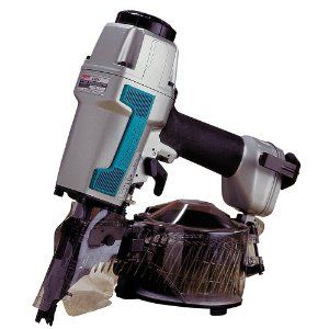

    Dunno about Bostitch; my siding nailer is Makita and it has a nice big hook on it that's easy to stick in a hammer ring on my belt.
