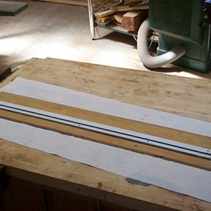

        Boats,I use a shoot board, the cajun version of Fein system. For foot Johnson straight edge screwed to a piece of 1/4" ply.KK

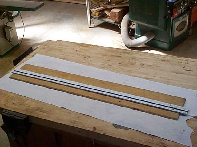

            Pop a line on a 8" x 48" piece of ply, attach a 1x2 to it. Run saw along 1x2 and you have a shoot board. I use the Johnson straight edges that lock together. Crude version of Dino's EZ.Mark door, clamp on shoot board, knife cut line, cut. We have multiples in the work trailer marked with which saw or router they work with.I'll try to take a pic and post later.KK

            coonass | May 15, 2009 09:05pm | #21
            I can't type too good so my explanations are short. You can get these straight edges at the big box. 8' for $20.Built a whole set of stain grade plywood cabinets long ago with shootboards. Some set to rip miters.KKCan't seem to attach pic.
            Edited 5/15/2009 2:07 pm by coonass
            coonass | May 15, 2009 09:12pm | #22
            Pic

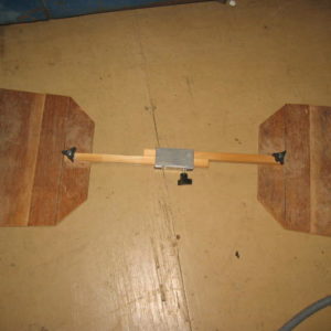

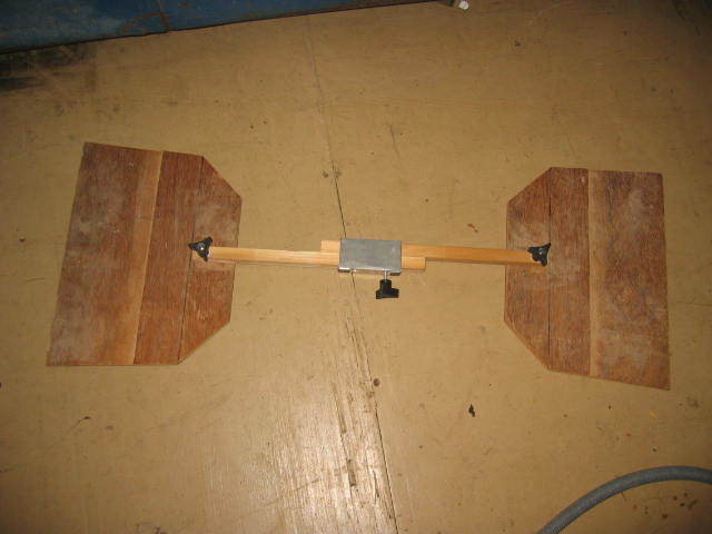

    Here's a version of what coonass is talking about. This particular jig is two short sections of shooting board set up for cutting stair treads, but I have 5' and 8' versions, too.
    No need to measure when you make one, just be sure that the top strip of 1/4" ply (6"w or so) is straight, and glued and stapled on straight to an over-wide bottom piece.
    When you run your saw over it the first time, that will automatically set the cut line. Then clamp it to your door, score along its edge with a knife, and make your cut.
    Sure, use your best blade, but you probably don't have to buy a new one, you'll just have to sand the cut a bit more.

      1. AitchKay | May 15, 2009 05:54pm | #20
        Yeah, it's a little hard to see in the pic that there are two offset layers of lauan. Once you know it, you can see how a circular saw rides on it.The view is also complicated by the fact that I draw a Sharpie line on my shooting boards. Outside of this line is where I clamp, inside it the clamps will bump the saw.AitchKay
