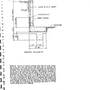

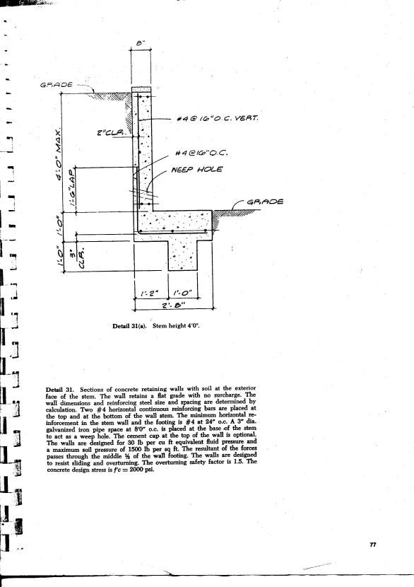

    Concrete is always my choice.  If you use forms for a thicker wall, you have room inside the form to place whatever you need to give your wall the appearance you want.  Here's a stock engineering drawing for a 4' wall.  You can put the footing on either side of the wall.
    1. DanH | May 19, 2012 07:45am | #4
      I wonder how vertical that wall will be in 20 years.  (Of course, it depends on location -- might survive better in the South, with non-expansive soils.)
      1. VaTom | May 20, 2012 08:32am | #5
        Dan, if you're asking about expansive clays like bentonite, that needs to be addressed.  My experience with concrete retaining walls goes back over 40 years, including the parts of Denver where bentonite can collapse a basement.  This is a separate issue.  One which must be considered in the south also, anywhere expansive clay soils exist.
        If you're asking about frost heave, there's a reason why foundations have different depths required.  Why I mentioned that the footer could alternatively be placed under the fill, which I usually prefer.
        The question was what type of wall to build.  Reinforced concrete works extremely well and I've not found a cheaper way to accomplish the task, long term.  Easy enough to make it look like almost anything.  As you go higher, you just need appropriately more wall and footer.  I've got 15' of fill behind some of my concrete retaining walls.  That's a BIG footer with considerably more rebar, but still cheap overall.
        That wall will last as long as the concrete.
        Last fall I visited my old place in Denver, with a similar short concrete retaining wall looking like it did 30 years ago.  It was great to see what the current owner had done with that 1911 commercial building.  He was excited to meet me, responsible for some major changes I'd made.  The dove-tailed hickory stairs to the roof really got his attention.  The retaining wall he never much noticed, it just sat there, doing what it was supposed to do.  I also drove by the 11 acres of apartments I'd helped build the concrete foundations for when I was in school.  The engineer apparently got the bentonite preparation correct.  IIRC, they were planning for 6" of soil expansion.
        Yup, I'm a concrete fan.  Haven't found anything better for walls.  That's why my house is concrete and I consult on other concrete houses.  One was buried in France earlier this year, which I'll visit in August on part of a concrete house tour, mostly thinshell.  Friday I drove a deck guy by a 4' retaining wall I cast many years ago.  From 10' away it looks like a delapidated board fence, with rotten lumber, 75' long with a curve.  Just what the client wanted and didn't mind paying for the colored concrete.  Got the wheels turning in the deck guy's head, the lifespan and flexibility of reinforced concrete.
