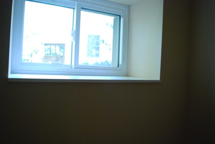

I used some plastic drywall J bead on half-inch MDF with a couple coats of good latex primer/paint at the windows on my basement to isolate the window from the extended sill.

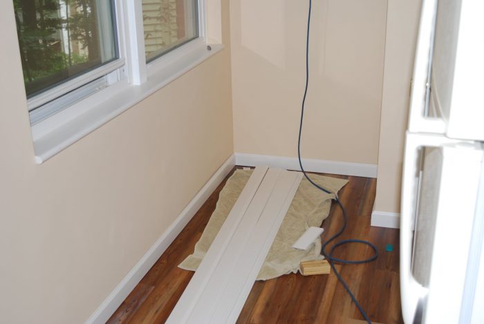

We had vinyl replacement windows put in 15 years ago, and I put a vinyl sill in when I redid the basement for a pair of windows.
This is really just interior trim, and does not go under the actual window.
I think it came out nice. Baseboards also are vinyl for this walk-out basement.
Replacing the sill on an otherwise still wood window might be more of a challenge.
This is one of the deeper windows with the MDF and the J bead. I also used the J bead on the drywall where it meets the window.
The MDF just has about three coats of latex all around, and is set in a couple dollops of poly construction adhesive on some 3/4 inch pine strapping I put in for support.
I will have to let you know in ten years if this turned out to be a good idea.
Note that this window is too high to sit on (if you are not a cat), I would want to put good support to have an actual person sit on it.
Thanks for the picture. That looks good. That's exactly what I imagine ours will (should) look like. Some Kilz with latex on top should probably do the trick.

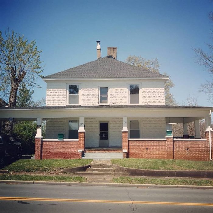

100 year old masonry house- wow post some photo's sounds interesting.

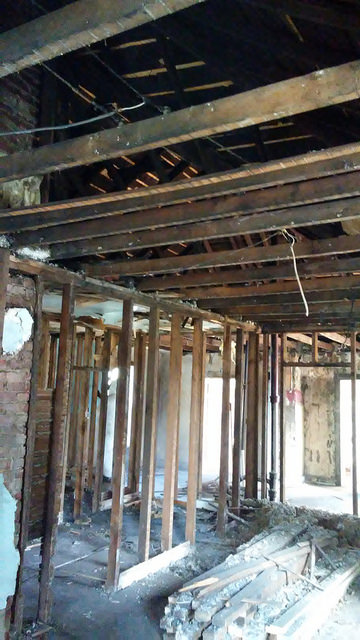

Thanks! I'll be on the lookout for a lumber yard. So far, no luck. We've got saw mills and Lowes. Here's some photos of house in progress. Looks much better on the exterior, for now. And a link you might find interesting about how the rock face block was made (hint: sears meets Appalachian farmers with not much to do in the winter) https://classicrockfaceblock.com/history-of-rock-face-block/
