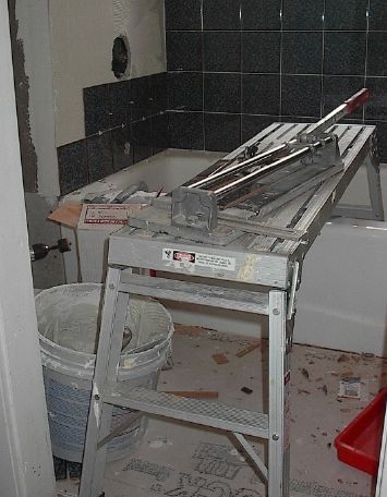

Here is another use of the bench when tiling a tub surround, to avoid climbing in and out of of the tub, or bending over to reach a tile cutter on the floor.The cat belongs to a customer, but I do have another clone of it at home too.
