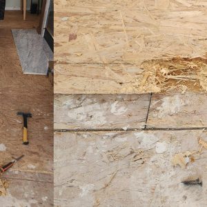

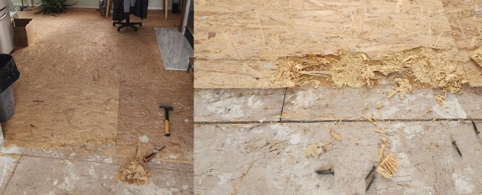

Gentlemen,
I am trying to remove half an inch of OSB subfloor from my living room. It has been very challenging even to remove a small portion so far. All the panels are both screwed and glued.
Even if I remove all the screws, I cannot pry them up and remove them as OSB is splitting into million pieces.
What would be the most efficient way to remove the glued OSB subfloor?
PS: I removed linoleum flooring all around the house. The living room is the only area left with 1/2 inch of OSB subfloor. To even out everything I want to remove it.
Thanks for the help,
Regards,

      Thanks for the tip, I will try this next. I tried the SDS hammer drill recommendation as well, it was comparably easier than using a chisel but still, OSB was splitting like crazy.

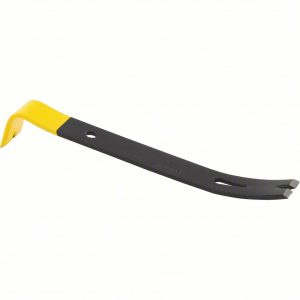

      I have 3 or 4 of these OLD Stanley’s and start them along the edge maybe 6” apart. Continue driving them a couple times, one after the other. Do enough and you can get a bigger wrecking bar under there and maybe….
      The old ones I have 40 yrs or more old, are probably different which might affect the workability.
      Sucks but works.

        I glossed over the screw part because in my case the ply was nailed. Definitely remove those screws! And I really like the idea of using a series of pry bars and hammering them in in sequence. That method should really be effective after screw removal and cutting your squares. Let us know how it goes!
