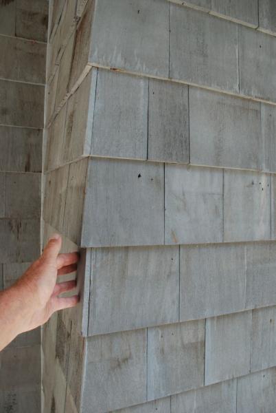

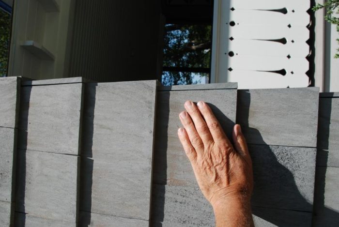

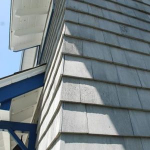

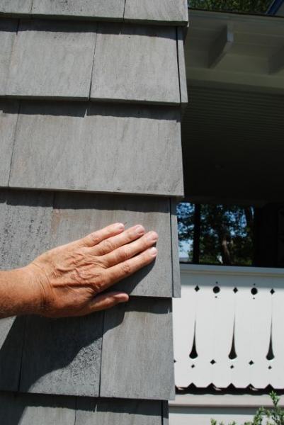

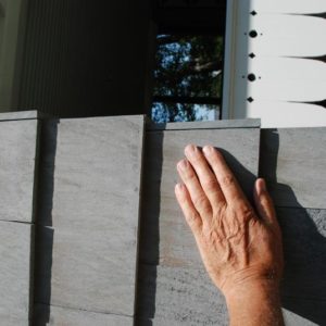

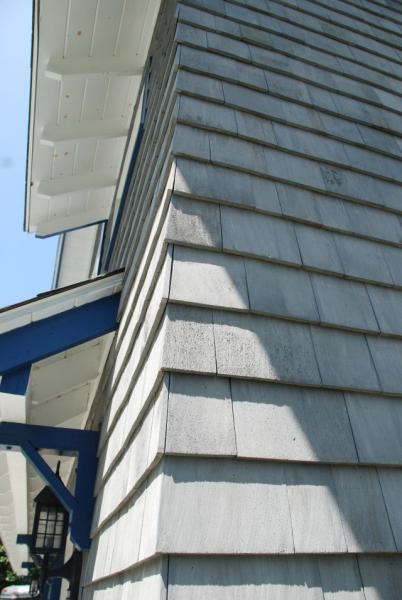

          1. MikeSmith | Jul 11, 2009 03:47am | #13
            we hold the shingle in place....trace the trim with a pencil... then cut to the line
            the guys use a sabre saw... i use a 4"  PC trim saw..
            then we nail the shingle in place and move to the next one..
            here's some RC factory dipped we  installed two years ago
