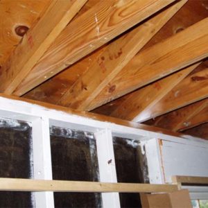

I’m going to eventually blow cellulose into the attic, so I need to install insulation dams between rafters.  The house is brick faced, so not only do I not want to block the eave vents,  I also don’t want to fill the gap between wood wall and brick.
Since I often take the “long way ’round the barn” when doing stuff like this, I thought I’d throw this out here and see if someone had a better method.
The current thought:  From scrap ply, cut a piece to fit between the rafters with a notch removed to slide a styrofoam chute into.  The styrofoam gets stapled to the underside of the roof sheathing and the ply bridges the vertical space from the top plate.  Then foam-gun all the seams. (the two screws in the pic are just so I can hold on to the ply).
Firstly, I’m not sure this is the fastest way to dam.  Secondly, if I want to make the ply vertical, I’d need to attach blocks to the rafters to attach the ply to.  Without the blocks, the ply would simply be set on the top plate and leaned against the foam, but I’m not sure that is secure enough.
Ideas?

  1. DanH | Jul 31, 2007 08:46pm | #1
    What I did was use a bunch of corrugated plastic political signs that were two feet on the narrow dimension. Stapled each to two 1x2s on edge, placed about 1 inch from each side, with a short piece of 1x2 at the "business" end to hold the spacing. The 1x2s projected about 8" beyond the end of the signboard, and another narrow piece of signboard was attached to this.
    These were installed by sliding the "business" end into the eave, with the 1x2s up, then lifting the other ends of the 1x2s up even with the rafters and tack screwing them to the rafters. The sign board then ended up wedged against the rafters, and the narrow piece was wedged against the top plate.
    One nice thing about this scheme is that you didn't have to get any closer than about 4 feet to the wall/roof corner, making it feasible to do in my 4/12 attic.
    But this was a truss roof, where the joists weren't in the way as they are in your case. But maybe the above will give you an idea or two.
    Re your current scheme, I'd suggest maybe using a piece of rubber foam (available from a fabric store) instead of the plywood piece. If you go with the plywood (or maybe use sign board), attach wedges to it so it can be jammed into place. (In fact, a piece of corrugated sign board, cut to your profile but 2" wider, with the sides folded back at about the 1.5" line, should jam into the gap nicely. A piece of 1x2 or plywood could be tacked across the piece to keep it from folding in the middle and provide a place to push.)
    I don't think there's any need to foam the cracks -- not much is going to get through a gap smaller than 1/4" or so.
