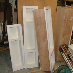

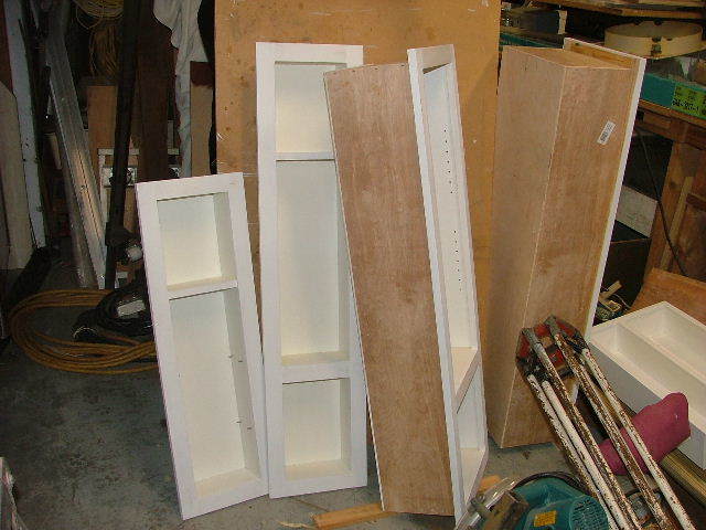

            Here are a few boxes made to fit between studs. They are simple 1/2" plywood sides, tops, bottoms and shelves enhanced with 1x2 face frames. Glue and staples for the boxes and glue and 16 ga finish gun nails to hold the face frames on. Used Kreg pocket hole system to make the face frames sturdy.
            I had the wall depth I needed for the job so the face frames fit right to the drywall.
            If you build the boxes carefully and to the depth you really need you can slide them into precut slots between the studs, making sure that the fronts of the boxes are in plane and level. Nail or screw them to the sides of the studs to hold them in place. Don't overdo the number of fasteners.
            To find studs I rap the walls with my knuckles to find the approximate location and then tap in a 6d finish nail several times to pinpoint the edges of the stud. Good for when you are attaching base or crown and need a precise location. For the type of holes you will need, just plunge your saw into the wall, go left and right until you find the stud and then cut vertically.
            You may encounter wiring, so it's best to punch an inspection hole before cutting. You can always buid boxes to straddle wiring whether it's vertical or horizontal. I would try to avoid any stud bays that have pipes, but you could work around that, too.
            Now you can rip a strip of finish material to wrap the entire set of boxes sticking out from the wall. Maybe use contact cement to avoid having to fill nail holes. Instead of wood you could wrap with drywall strips and tape, finish and paint to match the wall.
            Finally, you can build a face frame to fit the face of the box array. You'll have vertical pieces for the two outside edges of the array as well as for covering the voids created by the studs and then the two horizontal pieces for the top and bottom.
            If you can bring the boxes close to the floor you can wrap the bottom to match your baseboard. Search through the Photo folder for examples of that.
