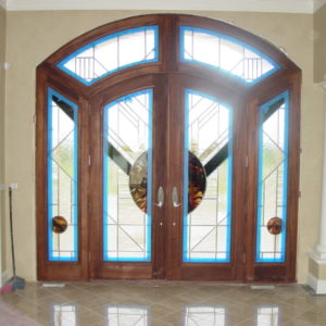

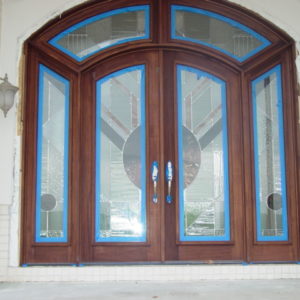

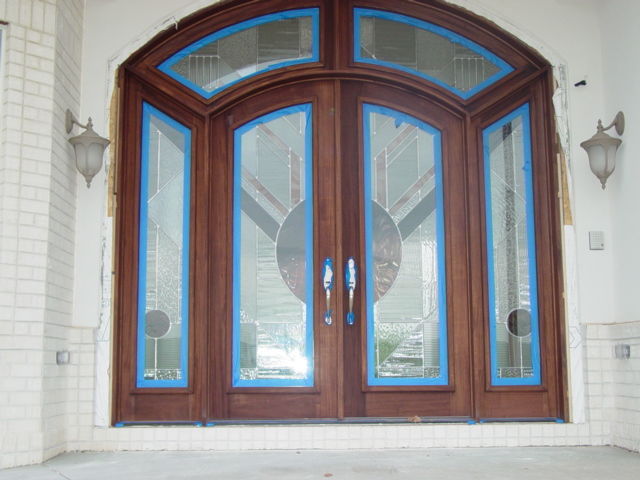

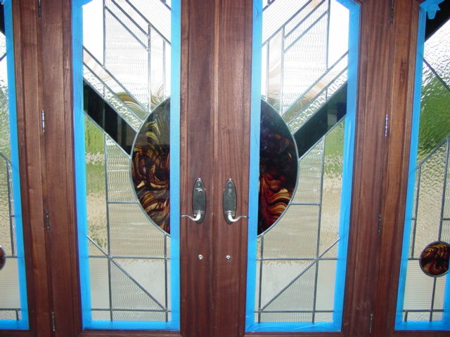

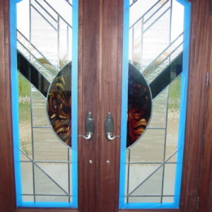

I’m posting some pics of a door I built and installed.  My buddy did the glass which is awesome! and we installed it into the frame together. There is blue masking tape visible in the photos as we are getting ready to varnish the wood.  Door is built of mahogany and is 125 inches tall and 122 inches wide.  The doors themselves are 8 feet high and 6 feet wide together.  Both sides are active.  I’ll post more pics after we get it varnished and get the tape off but there is enough here to give you a good view of it .  Hope you enjoy!  BTW this house is about 1.3 million.

            Excellent work! The art glass is nice,too!
            Looks like the glasswork is encapsulated- in house, glass shop. or production facility? My first career was doing art glass for 25 yrs. Like to see more of your wood/glass collaborations!

            Ken,
            Thank you for the kind words.  The glass itself was made up in my buddy's studio and then he sent the units out to be insulated.  If you would like to see some of his other work his website is http://www.designerglass.com

            Beautiful!  I hope you used some really high end heavy hardware like from Rocky Mountain.  The scale of the entry demands some monumental pulls.
            BTW, what did you get for the job?  A good friend of mine owns Craftsmen in Wood, a Phoenix company that does about $20 million a year doing doors, all of them big and heavy like the one you show.  Everything for exterior is 2-1/4 thick and thicker.  My guess is that an entry like that from CIW would go about $20 grand, less the glass, but including a factory finish.
            What grade of mahogany did you use?  Pattern?

            Mr. micro,
            Don't I wish .....Didn't get anywhere near 20 grand not even with the glass.  We are finishing the door as well.  Used clear mahogany and didn't worry too much about color differences as they were originally supposed to be paint grade, but changed their mind after they were done.  had to do some tweaking to bring them up to stain grade which kind of ticked me off.  However the stain is dark enough that it doesn't matter.  Next time they will get quoted as stain grade period, no ifs ans or buts.  If they don't like that then hit the road jack cause I ain't going thru that again.  Live and learn I guess.

    That is one awesome design!
    The way the lines lead to center but explode way from it at the same time are inviting. A very welcoming pattern language. Plenty of light on the inside.
    Absolutely love it.
    1. kennedy136 | May 28, 2003 07:43am | #10
      Piff, You know I told the GC on the job that it really didn't matter what my wood looked like as everyone would be too busy looking at the glass.  Looks like I was right.  Btw I can hook you up with my glass man if you need anything.  They can do anything you can think of and then some.  I met this guy at a big Home and Garden show about a year and a half ago and we have since collaborated on a bunch of stuff although this job is the most elaborate so far.  FYI: I posted several pieces on Knots under the threads of Chess table and chairs and also Cherry highboy pics.  I know you like my stuff so check 'em out.

    Beautiful work Professor. What sort of joint do you have at the top inside corner where the arch meets the sides? Those doors must weigh a  hundred pounds?
    Joe H
    1. kennedy136 | May 28, 2003 02:47pm | #18
      Joe,
      Thanks for the compliments,  as to the joinery all but the transoms are mortised and tenoned into their separate assemblys.  the transoms are lagbolted together and then all the subassemblies are lagged together as well.  The doors are probably over a hundred pounds each with the glass in them.  That's why I used 4 ballbearing hinges on each door.  Later.

      Thanks  I appreciate the kind words.  It was a challenge figuring out how to build it, not to mention manhandling it around.  had to haul it on my gooseneck trailer with it brace at an angle.  It was too wide to lay flat (I'd have been overwidth) and if I had stood it up I'd have been over height.
