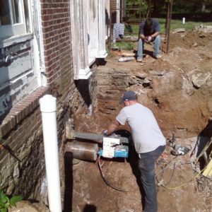

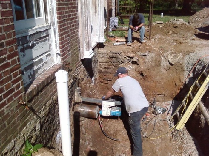

We had a fun day, 4 6″ diameter core drills for power and 3 @ 10″ diameter for outdoor furnace H2O lines…
Actuallt shocked me how fast they could motor through the stone. The 10″ holes took less than 1/2 hour each.
18″ thick stone foundation..sorry about the pic quality it’s my fone, and I am still getting the hang of getting the pics to come out photo wise, AND off the mem card..damm technology is confusing.
I think his helper had a tuff night, hizazz was draggin..LOL

    Nice drill!

      100.00$ an INCH. that 10'' is a grand, no clue what the motor costs. That was the first ele. coredrill I saw, most are hydraulically spun.
      I got to VERY, VERY carefully layout the hole locations and attach the unistrut backing bar to the allthread thru bolt that the drill mounts with.
      I got 1200 amps coming into two "Tubs" via the conduit and the tubs HAVE to be just dead on in the basemant, like 1/4" tolerance at most...then the water lines in the 10" holes I have plenty of room in the sleeve, but the septic stack was with in an inch ( all new cast iron) of where the hole was to be..can't drill a pilot from inside ( all the water would leak out of the core bit) and it was all measured from the center of the doorway.
      We nailed it dead on with every hole..wwhheeww..Spheramid Enterprises Architectural Woodworks

    Cool drill........Shoulda had the helper prepping for the paint job.

    I think it is pretty darn good for phone cam!
    Cool job!

    That guy is hung over like no tomorrow!
    Reminds me of this guy begging the boss to let him sleep in the truck
    for just an hour and he would work the rest of the day for free.
    No go with the boss by the way.
    Made him run scrape paint all day.
      Sphere | Sep 25, 2008 03:45am | #8
      He did Ok considering, they switched off on each hole, and he was as good as the other guy, just wrung out and tired.Spheramid Enterprises Architectural Woodworks
