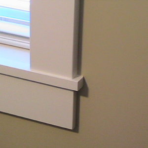

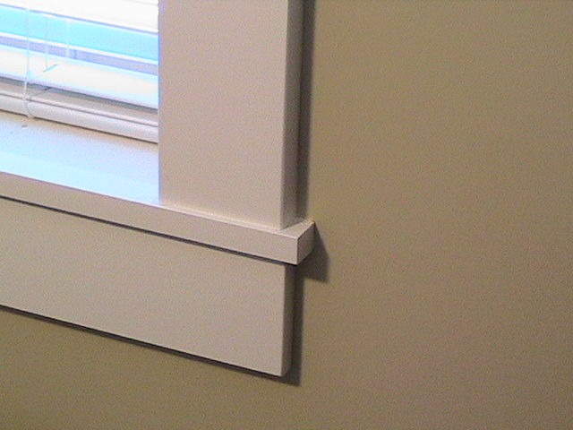

  9. alrightythen | Sep 30, 2006 06:47pm | #13
     here is a case where the side casing meets the window sill. one often encounters the same problem where the reveal will be off because of the wall.
    I don't think you guys use a biscuit here do you?
    I like to shim it until the reveal is even.
    1. woodguy99 | Sep 30, 2006 08:49pm | #14
      In that spot, I install the stool cap first,
      brad nail the side casing to the jamb,
      hold the side casing so the reveal looks good,
      then nail up through the stool cap into the side casing with 15ga or 16ga nails.
      I figured that out taking apart work that looked good after 100 or more years.
      Back then they didn't biscuit the side casing/head casing joint, but I bet they would have if they had our tools and the material we have to work with.
      1. davidmeiland | Sep 30, 2006 08:52pm | #15
        I do the same thing... tack the casing leg to the jamb, then 2 nails up thru the sill into the bottom of the casing. Biscuits are useful at the top of the assembly, especially when the legs and the head are the same thickness. I always prefer to use 5/4 for the head, or plane 1/8" off the legs to get a reveal at the head, but some clients like it flush. I just did a house that way, everything 1x except the sill were 5/4.
