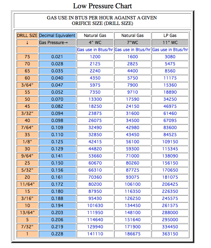

If you only intend to use this for a log lighter then this is ok. If you want it to burn continuosly you'll be wasting gas. To get more heat you need a venturi to mix air with the gas before it burns. I've made a couple of burners with jets and venturi, but it's tricky. In case you want to make your own burner here's a size chart for the orifices.
