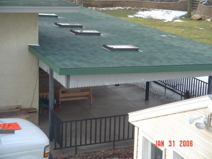

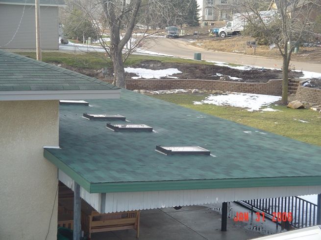

I'm posting a pic of a covered porch I had to rebuild due to leakage...and to make matters worse, they also had skylights!
ps. disregard the first picture. I resized it after the fact and don't know how to take it off.
Good info, Charlie.BTW, you still have one on the way, or did the oven door fall open?If this is already built he will need a perfect I&W shield under the shingles and will need to expoect a shortened life for them.I would no touch this roof without tearing off the uppper roof. Four gets you one that there is no tarpper anywhere in the upper.
