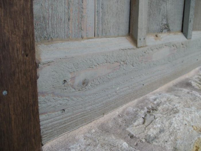

Any ideas on how we can successfully install cedar board and batton and keep water from infiltrating the seams and the soldier course of stone? I love this look but I’m getting many words of caution from my frammer, etal. We intend on wrapping the house with tyvek, then possbiley using a rubber bladder material used for shower pans to go behind the siding and over the soldier course of stone. We will also use metal flashing behind the horizontal trim and cut the top of the trim at a 45 degree so any water will shed off. See picture.

    The tannins in cedar will disintegrate tyvek. You should use tar paper or Typar. I prefer 30# felt. Do not nail the edges of the boards. The boards need to expand and contract with the humidity. I use one nail in the center of the 1x12 board and one nail in the center of the 1x3 batt. Space the boards about 3/4". If the boards are low grade and do not lie flat then you might use two nails at one third the distance from the edge. Instead of horizontal blocking between the studs use 2x4 horizontal sleepers at 2' centers behind the B&B to provide nailing and to let it breathe. Try to get cedar that is at least 1" thick. Spooge the back of knots that may work loose with a little gorilla glue or PL 400. Use stainless steel nails.
    I would use copper flashing between the stone water table and the B&B. Let the stone masons come in later and build up to the flashing.
    I think a 45 degree bevel at the top of your trim is too steep. I would prefer a 10 degree.

    Install flashings at bottom of boards before the stone work is done.Felt after flashings installed , or at least ensure the felt goes on top of the wall flashing leg. (DUH... but have seen it done the other way!)
    I was taught one nail per board within 1/3 of the board width, then float the other side of the board, the batten when nailed will hold it in place and let the board shrink and swell with moisture content.Two nails if 1 x 12 boards, as detailed by Mike in his post above. Do not nail the batten into the boards. Blocking in the wall 24" o.c. or strapping over vertical lathe for drainage.

    Think of the cedar as just there to keep the sun and wind off the typar or felt and the flashings at the top of the stone. The main thing is to get those flashings done right and to allow any water that soaks through the stone to escape through weep holes at grade. Once your flashings and house wrap can keep all the water out of the house the only issue with the cedar is making sure it can dry quickly when it gets soaked (an air gap at the bottom, perhaps a rain screen or cedar breather type product)this should keep it from drying un-evenly and warping all over the place. Think about the expansion and shrinkage as you place your nails. about a third of the way in on the boards and make sure your battens are well secured to your purlin blocking.
    The other issue with Board and Batten is the window and door detailing. We pack em out with one by two around the RO so the cladding is out 3/4 from the sheathing. It's a funny looking detail and it works better with house wrap and tape rather than tar paper. The point is it allows you to run your 5/4 window trim over the boards and in plane with your 3/4" battens. I hope this is clear as I don't think I have any photo's of it.

        you have had some good advice already. Just keep in mind the rainscreen wall concept because B&B is one of the worst sidings for keeping wind driven rain out.Tarpaper behind and a drainage plane.Allow for shringage in your nailing.I use about 15° for that sort of flashings and agree that B&B should stay free of the flashing a bit.

    Keep the bootom end of each board, and each batten, up off of the flashing by about 1/8". Although this will leave a tiny shadow line that some might find unattractive, it will keep the boards from sucking up the water.
    You also asked about how to handle the seams. The nailing methods mentioned by others are good for the vertical seams. If you must have any butt joints (horizontal seams) in a board or a batten, be sure to cut the joint on a bevel. It will hide the joint better, and will shed water if done properly.
