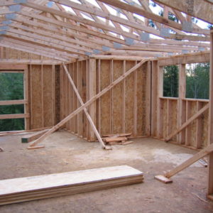

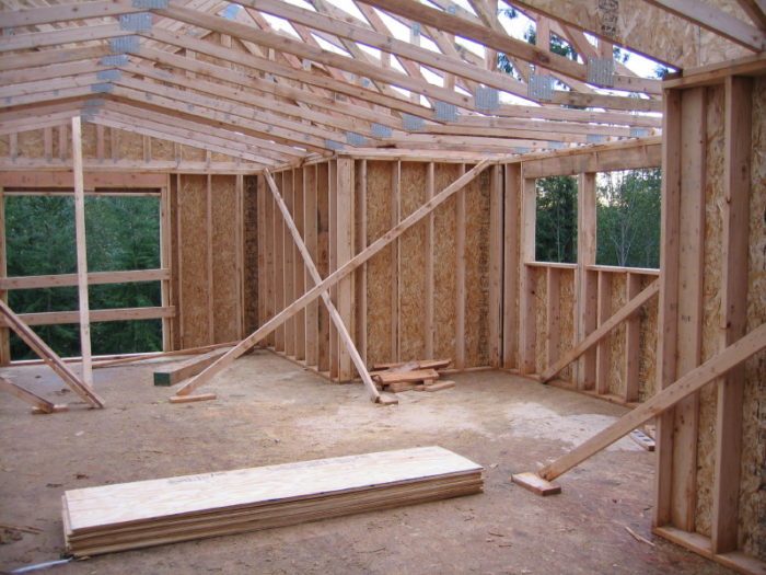

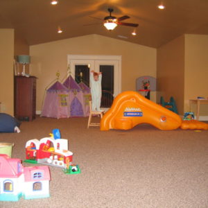

  8. deskguy | Jul 28, 2006 11:57pm | #21
    I saw the plan on Boss's site a while back and really disliked those skinny dormers.  On the Back of the house they look silly to me.  On the front, the bonus room,  all they do is create two long, unuseable tunnels.
    If I were to build the house I would put a single, wide dormer on both the front and back of the bonus room.  In fact, that's what i did on my own house. (pic. 2305)  It would really give them a nicer room.
    Found pics of the finished room and the truss's .
    As for the one's on the back.  I think if you could center them in the bedrooms, and possibly use a shorter shed dormer with higher windows???  I think the one on the left may complicate it since it would be half on and half off the porch roof line below??  But it would really make the two bedrooms nicer. more natural light coming in.
    All it takes is more money  :)

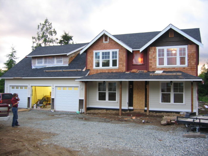

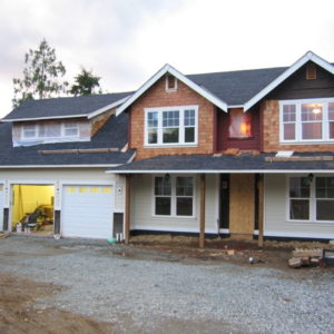

      Gene_Davis | Jul 29, 2006 01:05am | #22
      You're right, Deskguy, but, hey, ya gotta realize, it's a Donald Gardner plan.  All about the icing, and no cake inside.
      You may not have seen the pics I posted of the house in my 'hood that got built per this plan, but the builder did at least one thing right.  He did the dormers for the bonus-room-over-garage (why do they call them "bonus') as wide single sheds, front and back, just as you did.
      Except he did it the (more or less expensive, depending on labor, etc.) stickframed way.
      You are right about the rear dormers as well, but the local builder here deleted them completely.  Done shorter and repositioned, they could have offered some nice needed light into what are otherwise poopy little under-roof bedroom spaces.
