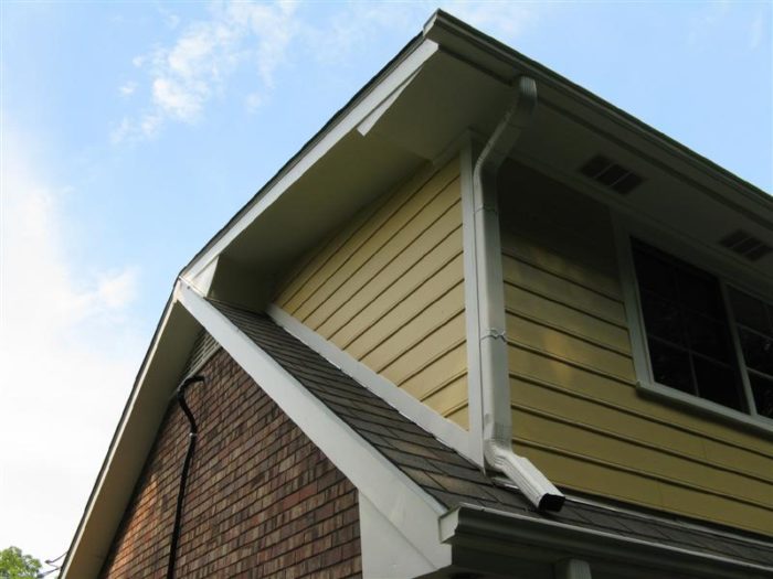

        2. Hackinatit | Sep 25, 2009 12:22pm | #9
          Yea, we do. Some of us think that tight siding is preferable to the blind nails and waves.. some hacks can make them all but disappear.

            Dam_inspector | Sep 25, 2009 01:52pm | #11

          2. Hackinatit | Sep 25, 2009 04:02pm | #12
            Thanks for the complement. If you were looking in person for the nails, you would easily find them. Otherwise, they become part of the field and are left unnoticed.
            The instructions point toward blind nailing UNLESS IN HIGH WIND APPLICATIONS. Why is that?
            Maybe face nailing is better able to hold the lap down... in which case, it is my preference based on that alone. I still prefer the look when the bottom of the lap is hard to the piece below. So I have two reasons.
            1.75" dbl galv Bostich roofers are penetrating the stud 3/8" when applied through 1/2" sheathing. While that isn't what the specs call out (2"), the difference is that I always nail to the stud instead of relying on the sheathing alone. I'm also much better at hammering the wider head of the roofer for the final set without breaking the surface of the siding. The head of the roofer is plenty wide and flat to "disappear" with a bit of caulk and paint.
            Lastly, IF I need to remove the nail for any reason, it is easier for me to use the prybar under a roofer than a siding nail without too much damage to the lap.
            So, I do it wrong... but I know it's ok in the long run. Plus, the look of wavy siding caused by blind, thick-headed siding nails holding it proud won't make me grimace every time I see it.A La Carte Government funding... the real democracy.
