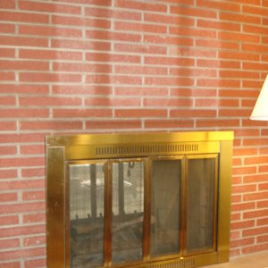

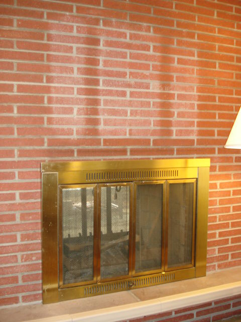

    Yossarian99 | Feb 15, 2012 09:33am | #10
    Two sided fireplace
    Our house has a two sided fireplace, and it doesn't draw well at all.  Reference the picture and notice the smoke stains on the brick from the previous owner.  As of now we don't use the fireplace because of this.
    It is a really neat feature in the house, but it needs to be modified to be functional.  Anyone care to suggest good brands for a gas insert?
