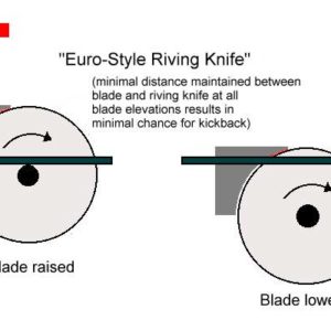

    I love the riving knife on my table saw. With a 12" blade and a 5hp motor it scares me, which is a good thing.
    Lots of different push sticksalso.

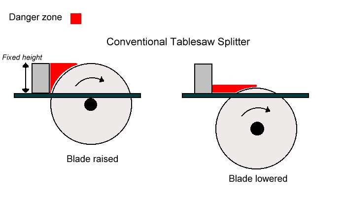

      Personally I think the old addage about only raising the blade far enough to barely clear the wood is a recipe for kick back.  I've drawn vector diagrams of the forces involved several times, and am convinced that keeping the blade low makes kick back four times as likely.  Because the distance to the top of the blade where the nergy for the kick back is so short that when the wood lifts, it is in kcikback instantly.  And, the low blade setting means there is far less force exerted by the saw to help keep the work piece on the table.
      I think it is one of those things that has been repeated so many times it is now accepted fact.  Even though an analysis of the physical forces involved demonstrat that it is wrong.

      2. Hokuto | Jan 21, 2012 10:17pm | #5
        Vector diagrams aside,
        My own hunch is that at least 95% of kickbacks can be prevented by the use of a proper riving knife that closely follows the blade; the riving knife simply blocks the back, rising side of the blade teeth where most kickbacks start to get their purchase. An Inca-style riving knife allows both full-through cuts and partial-depth cuts; and of course, the use of a feather board helps.

      While this may be true, it certainly isn't in this case.  Resawing on a table saw is a usual activity on the job or in the shop.  To be honest, so is running the work partially through and then flipping and running the other end through.
      Further, blade height.  When set too low, you can feel it actually trying to lift the work.  But, too high and I feel too much friction (eventhough the teeth are wider than the blade surface).  I definitely  want the blade higher, but not by too darn much.
