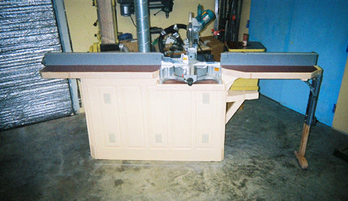

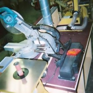

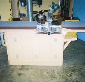

  5. BilljustBill | Jan 01, 2010 12:25am | #6
    If you add a 220v floor plug for your table saw, run a wire cable that also has a green ground wire. Using a four wire cable, or an extra wire that is solely a ground, you can tap into that floor plug and at the end of the table saw you can have options for an addition 220v plug for another big tool or the abillty to have several 110v plugs for those portable bench and power tools from a small subpanel.
    When you build your roofing framework, be sure to "beef it up" so you can use the attic floor for storage and consider 'walk-through' trusses for easier movement from one end to the other. With a big snow load, I'm betting you'll have a steep pitch roof and lots of possible storage area. Just remember where it comes off the roof and think about any doors that will get blocked.
    At the local monthly flea market several years ago, a fellow would come with a long and wide low-boy trailer stacked 4' high with mostly unfinished Oak cabinet doors. He sold them for $3 each, no matter the size. I'd always pick out some of the tallest and widest of the solid raised panel doors. At that price, I couldn't even buy the hardwood, and could almost get as much surface area of Oak doors equal to the cost of a full sheet of 3/4" Fir plywood. I still have over 100 solid Oak doors up in the shop attic.
    Also, to help get all your "Some Day Treasures" into the attic...Safely..... ALWAYS spend a little more and get the pull down stairs made with wide 1" X 6" material. It's a heavier and more comfortable set of steps. I've used the attic storage so much, I ran an electrical branch circuit up there. I wired some two and four tube light fixtures with a 3-way switch, when I found one of those heavy duty $110 pull down stairs for $10 at the flea market. "Over Time", I've added the second set of pull down stairs, so I can add and retrieve at each end of the attic. If you can't store much of a load up there, or get your treasures up there safely, and you can't see what you've got, then the attic storage will become more for "dead" items.....
    With the help of that same flea market, I've purchased a 1 hp. Baldor motor mounted to a reversible automatic gate closer and while there, I've found steel cable, pillow block ball bearings, and government surplus worm drive gear boxes. This winter, my project is to make a sort of "Dumb Waiter" that can lift a couple of hundred pounds UP and DOWN from the attic...
    I had our old home's HVAC system moved into a corner closet I built in the workshop in the bid for a new Trane A/C and propane Heat system. It cost me just $200 extra. Now, with some multispeed, reversible, 48" ceiling fans, I've got an all weather workshop I thought I'd never own...:>)
    Being an young boy that grewup on a West Texas dry-land farm, I've become living proof of a woodworker that can stretch the shop budget almost as well as our late REZ did.
    Bill
  6. BilljustBill | Jan 01, 2010 12:31am | #7
  7. BilljustBill | Jan 01, 2010 12:31am | #8
