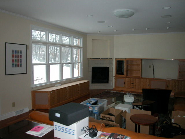

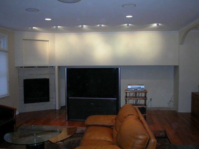

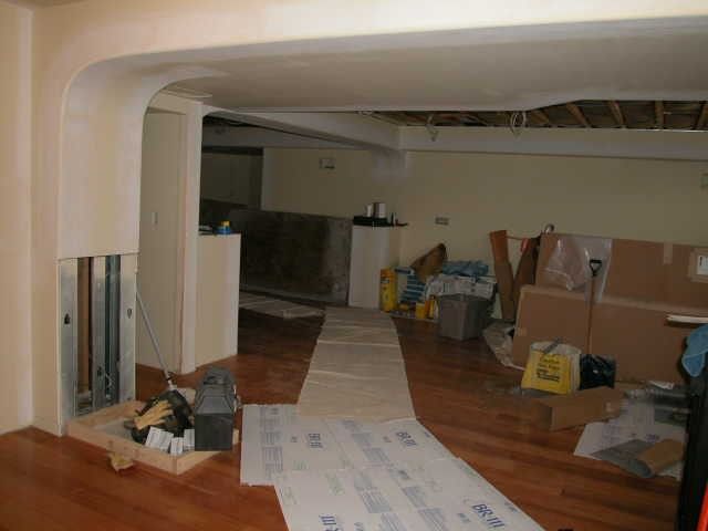

HO decided to give his big screen a built in feel …
also decided they needed a fireplace …
this is what he came up with ….
The fireplace guy framed and set the FP ….
I had to work off that angle for the bulkhead ….
bulkhead above the FP overhangs the front 6″ … the back wall of the recess is in plane with the front of the FP … the recess was sized for fit a painting.
The rest of the bulkhead is just there to fill space …
the same cab maker that did his study is gonna build cabs to run alongside the TV …
plans are for a set of false doors to run across the bottom of the TV …
to make for the look of a solid run of cab’s with doors … and the TV just setting up on top.
Somewhere in the mix is gonna be cab doors with cloth speaker grille screen to match the cabs …
This little wall hanging from the ceiling was a lottle more involved than she looked.
My painters truck broke down … so we did the framing … hung and finished the drywall… primed … trimmed … and first coated the color …
Gonna have a real painter do the final.
Artistry in Carpentry
BTW ... the "leg" ... that comes down next to the FP ... was added after the whole damn thing was built.
First the cab maker didn't want it .. then he did. Woulda been lota easier to build it in the first place .... woulda made for much quicker plumbing and leveling.
Had to do everything .. hanging in space.

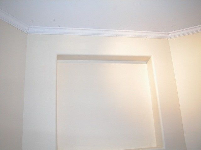

That crown pic ... I just had to snap that one ... goofy angled crown ... took a quick measurement ... and angle measurements .. and the thing pretty much snapped itself together ... very first test fit ....... almost shame to put nail holes in it!
My helper was amazed .....
Sometimes lucky is good ....

Same house ...
that's the upstairs we had to match in the basement.
after the original drywaller bitched and moaned ... then screwed up the drywall in the basement ...
we decided to do all that rock ourselves. Their "corner guy" applied the bullnose bead ... we did all the finish work.

here's one of the "Star Ship Enterprise" Bulkhead(s) .....
More .....

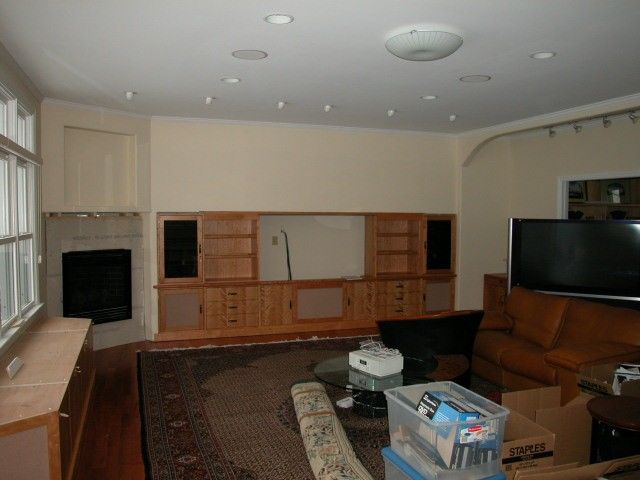

Here's a shot of the "bulkhead" after the cab maker did his rough install ...
Now the "hanging wall" should make a little more sense ...

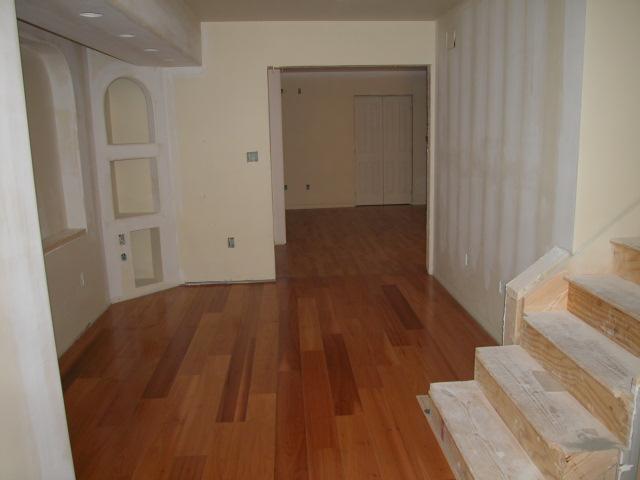

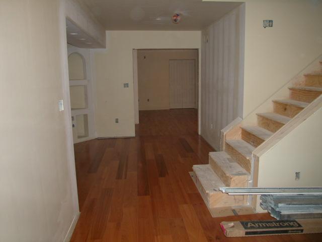

The picture with the laminate by the stairway, Are you gonna have to compensate
for the flooring on the rise of the stairway?
the same flooring is gonna wrap the stairs.
Gotta box out that bottom step ... they want a wraparound effect for the bottom step ... wedding cake stepped deal .. but now square
