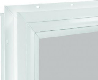

I am about to install a jeld wen sliding brickmould vinyl integral fin window, and using it as a replacement.  I have aluminum insulated lap siding that can’t be replaced. Old windows were 28 x 51(Exterior hole between j channel). The replacement is 60 x 48(rough opening) 62 x 50(outside of nailing flange).
The brickmould and j channel are already on the window itself. And will leave me a 1″ space around the window and 3″ on the bottom.    HOW DO I FILL THE VOID…, between siding and j channel on the window?
If I remove the nailing fin from the window and the void would be 0″, or flush, besides still 2″ on the bottom.
How do I fill the void on the bottom?

      Okay. I'm not home currently. But the windows aren't in. The siding isn't cut just rough opening from the inside is done. The old windows just had aluminum flashing over old brickmould, and then j channel butted to it. Lots of caulk.
      So I have to cut the aluminum siding back 1" or a little more than the rough opening, for the nailing flange.
      And you would just place another piece of trim next to the brickmould and j channel on the window to the siding? And it would look half a** decent.
      I have a cnc bed mill so I can do about anything needed to be done. And I will get pictures posted of new windows later.
      Another option and ? Would be could cut off nailing flange and just drill and screw through frame and caulk holes shut? Like a replacement Then I would only have a gap on the bottom from the old windowsill, which I was going to put a couple of small pieces of cut off siding to fill the void.
      Just didn't like the idea of going from siding then j channel, then off trim, then built-in j channel and brickmould again, looking right.

        1. Hondarider28 | May 19, 2020 01:45pm | #4
          Re read forum Calvin. I re worded it, and added pictures of my windows.
          I will build out will so it will mount flush since there is 2 layers of siding. But still stuck on how to fix the gap under the window.
          Since it already has brickmould and j channel around the window. Can I just add a small piece of siding under the window?

            I can’t tell if the new window is picture framed w/brickmold or if it has an integral “sill”. Either way I’ll stick with my first response but definitely look at it in the field.
            Tape in the fins for weather. Do whatever you can, bottom to top to keep out the water. Add new J to the either side siding. See if fitting pvc flat stock to either side ........and a “sill” sort of at the bottom.....fitting the top.....
