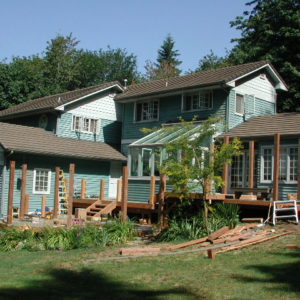

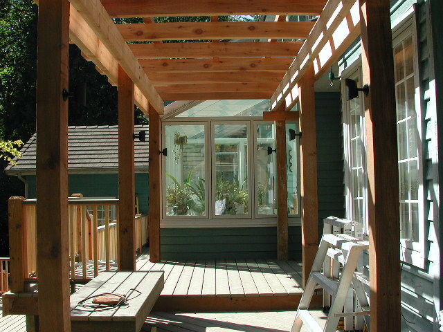

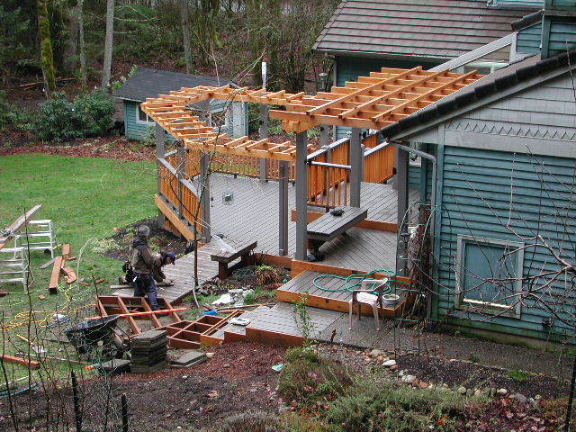

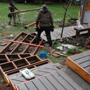

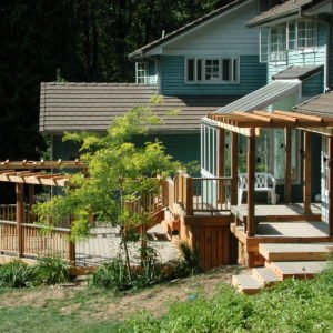

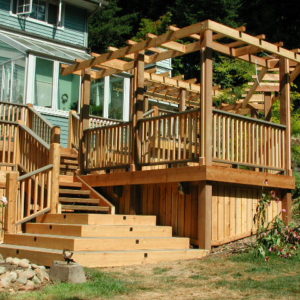

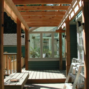

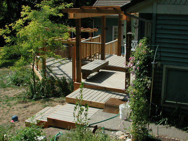

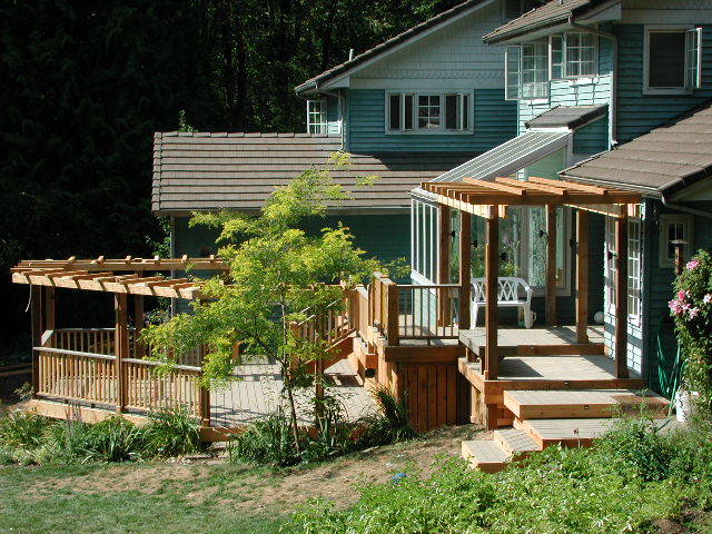

Just finished this multi-level Trex deck with,arbors and lights.

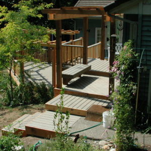

    ProDek | Aug 22, 2003 06:09pm | #1

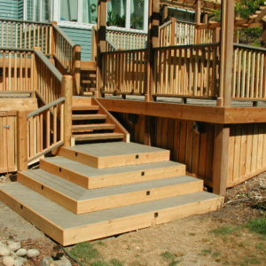

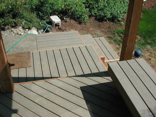

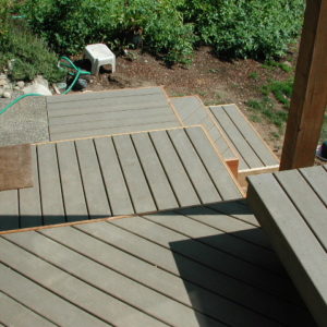

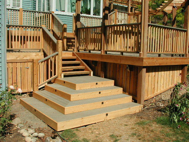

    Here is the platform steps with lights.

    1. Planeman | Aug 22, 2003 06:53pm | #2
      Beautiful work, guess that's why your called Pro-Deck!!

      1. djohan | Aug 22, 2003 08:45pm | #3
        wondering why you used wood for the trim boards instead of trex.  Looks like you added a maintence area to a non-maintence deck.  Nice job, tho.  Really looks nice.
          ProDek | Aug 22, 2003 10:09pm | #4
          We always use 5/4"x 10" fascia because it is usually painted the trim color of the house.
          Vertical wood is not really any more maintenance than say the barge board around the foundation of your house.
          Thanks for following along."Rather be a hammer than a nail"
          Bob
          ProDek | Aug 22, 2003 11:08pm | #6
          I forgot to mention that Trex does not provide fascia more than 8" wide.
          You may also note that I don't use Trex ballusters, I think they are cheezy and there really is not a good way to fasten them to the rails"Rather be a hammer than a nail"

        ProDek | Aug 22, 2003 11:01pm | #5
        Thanks Dave, If you build 15-20 of these decks a year your bound to learn something.
        The 14', fresh out of the pond, arbor posts were a pain to place inside of the framing."Rather be a hammer than a nail"

    2. JimLovatt | Sep 11, 2003 01:12am | #15
      Really nice, Pro!  Hey where do you get those little lights, low voltage I assume. How much are they?   jim
        ProDek | Sep 11, 2003 07:49am | #16
        Hi Jim, you can buy those step lights here for about $1.90 each
        http://www.itc-marine.com/index.html"Rather be a hammer than a nail"
        Bob

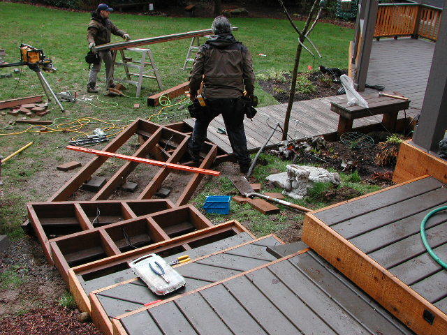

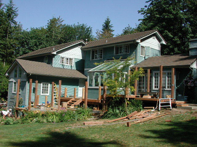

  2. DougU | Aug 23, 2003 02:49am | #8
    Pro

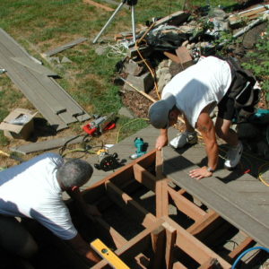

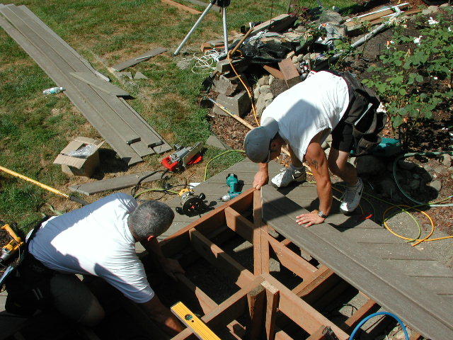

    Very nice work, but is that your boys doing all the work while your taking pictures?
    I like the platforms framed in and direction change.
    As always nice work.
      ProDek | Aug 23, 2003 03:50am | #10
      Well.............somebody has to keep a record of this...............
      I do show up to make sure they show up..........................
      Pick up lumber.......hammers...........and such
      Every now and then they say.......
      "Watch out! Dad has his bags on!"
      Bob
  3. JSpeidell | Sep 12, 2003 02:04am | #17

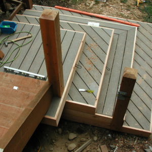

    Nice job!  On the section of stairs where you joined the tread boards at 90 degrees, did you butt the 45 deg. mitered ends tight or leave a gap?  I heard Trex expands over time due to water absorption.
      ProDek | Sep 12, 2003 05:53pm | #18
      1/4" gap must be left on all butt joints for Trex. You can get a Yellow Trex deck spacer that works pretty slick for maintaining an even spacing."Rather be a hammer than a nail"
      Bob

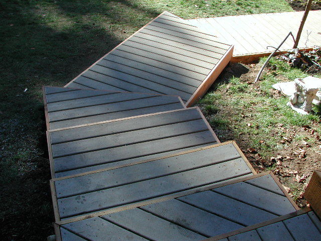

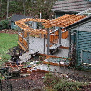

          ProDek | Feb 25, 2004 09:40am | #20

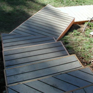

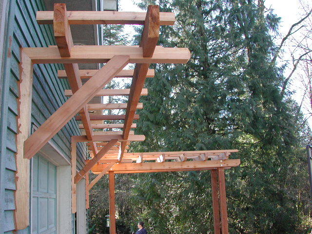

          We had to go back and connect the two decks with a Trex boardwalk. and build another arbor on the front of the garage.
          Bob

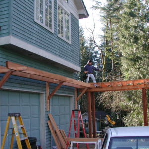

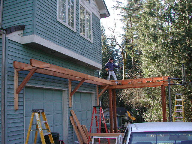

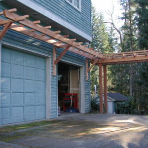

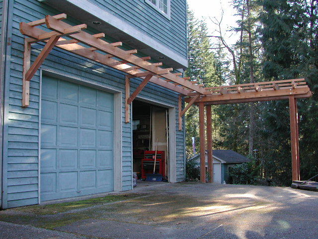

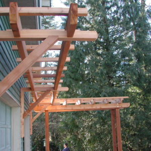

            ProDek | Feb 25, 2004 09:46am | #21

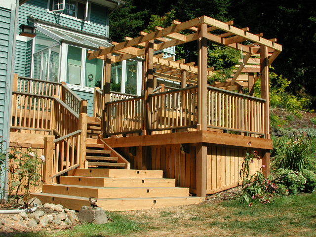

            Here's the front arbor...........
            Next thing she wants is an octagon gazebo with attaching breezeways on each side which have to support a glass roof."Rather be a hammer than a nail"
