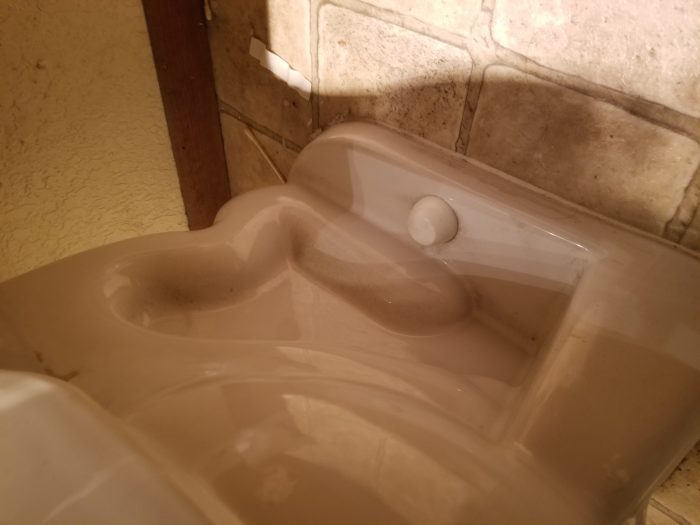

I have done all the measurments needed to find a toilet that will fit my counter tops but, I am wondering about the alaignment of the pipes. From memory, the piping in toilets I have grown up with, have been ensconced in a casing. Never knowing where the piping meets with the floor. Be it front, middle, or rear.

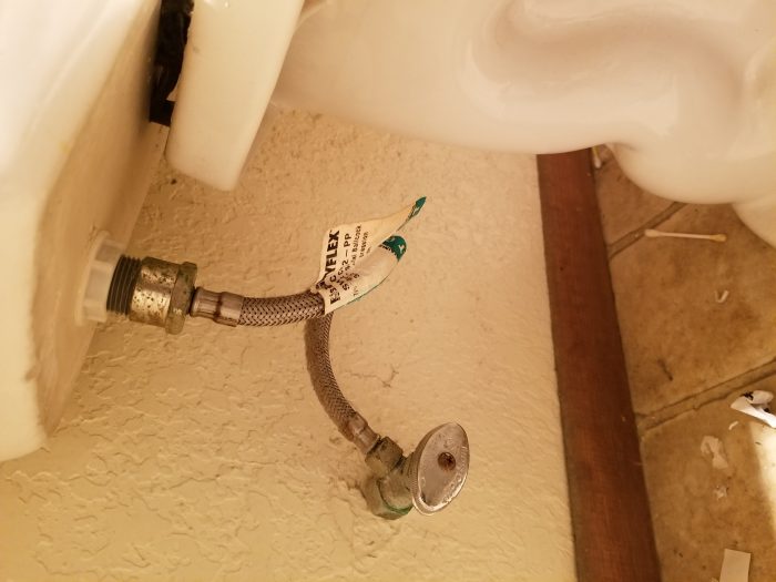

I have attached photos of the base, hoping for advise on purchasing the correct toilet for the pipe alignment.

Either 12" or 10" from the finished back wall to the centerline of the flange bolts. These are standards but could be different "in the field". Measure twice!
The supply pipe is either on the left (yours) or the right when facing it. Length varies between wall valve and tank connection.
The shutoff valve and supply line are pretty standard throughout the industry. There are a few oddball toilets out there that have a different inlet but you'd notice right away. The one you picture is a standard setup. All you need to decide is if you want a long bowl, you do, or a round one and what height seat you want.
Unless the toilet was a bad fit to begin with, and an "offset flange" was used, the distance between the center line of the bolts and the back wall gives the most important dimension. If this is less than 12 inches or uncomfortably close to that number then you should get a "ten-inch offset" toilet, otherwise a 12-inch offset unit will fit and will look nicer and give you more legroom.

* Often you can order the same toilet in 10 inch, 12 inch, or (rarer) 14 inch offset versions. You can afford to have a little bit of airspace between toilet and wall, but if the anchoring bolts are too close to the wall for your toilet, there's no way to install it.

* Frequently you will find that toilet shutoff stop valves of the type you photographed, that were designed to last 5-10 years, corroded themselves nonfunctional in a 'locked-open' position 25 years ago. Verify how your whole-house shutoff works, test things before you begin, and don't cheap out on replacements if needed; Go for a ball valve shutoff. https://www.familyhandyman.com/plumbing/valves/how-to-replace-a-shutoff-valve/ https://www.familyhandyman.com/plumbing/valves/stop-plumbing-leaks-with-ball-type-shutoff-valves/
