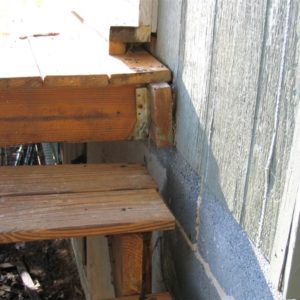

  • deck on south side installed over siding, no flashing, and is pulling away from house

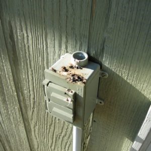

  • pipe flashing for electric service is split

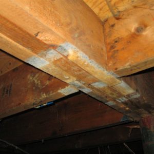

  • serious structural concern where girder is not supported at the splices

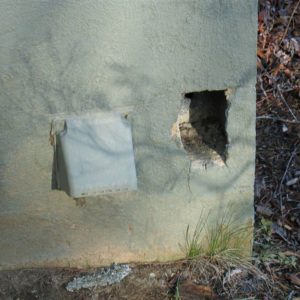

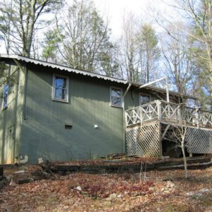

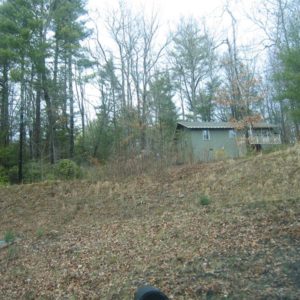

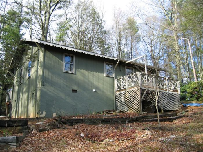

          First picture is driving up the driveway to the house. You can see one of the decks. This deck faces south.
          This is the north side of the house

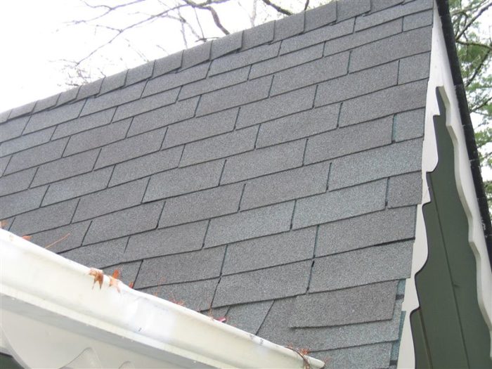

          The is a picture of how the shingles are improperly installed. The home inspector said they aren't on a 6 inch bond.

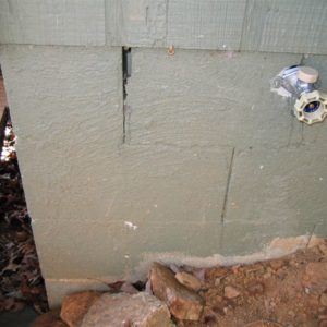

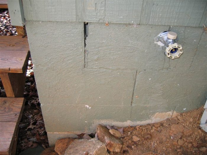

            This is a picture of the south east corner. The professional engineer reccommend digging down the the footing to see if it is cracked. If it's cracked he reccommends pouring a new footer, or using helical piers. I'd re-pour the footing.

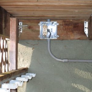

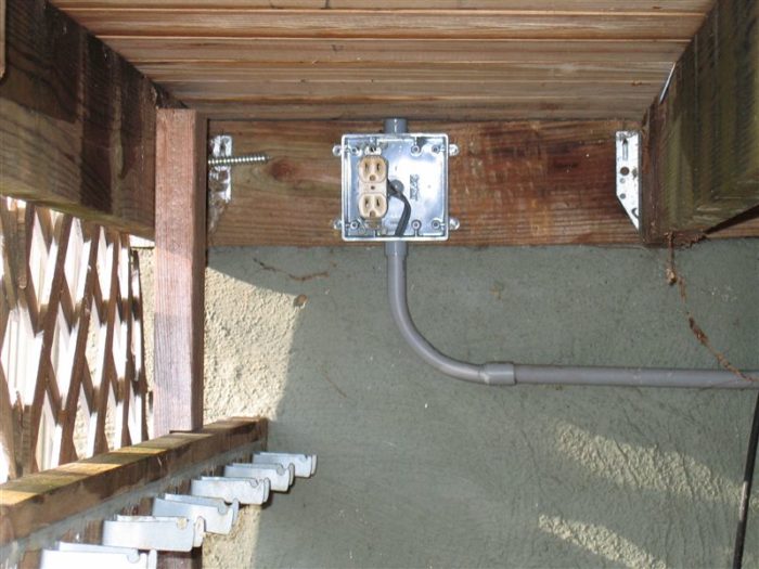

            This is the deck that is not installed properly. Attached directly to the T1-11 siding, with no flashing.

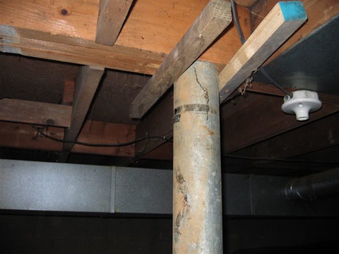

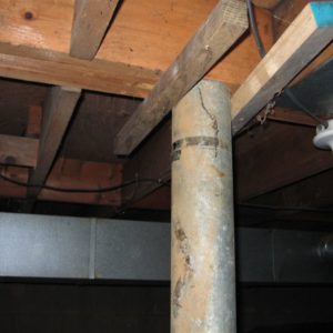

            This is where a pier was before they dug out the crawl space. They put galvanized poles in, but not under the splice, and no plate to distribute the load.

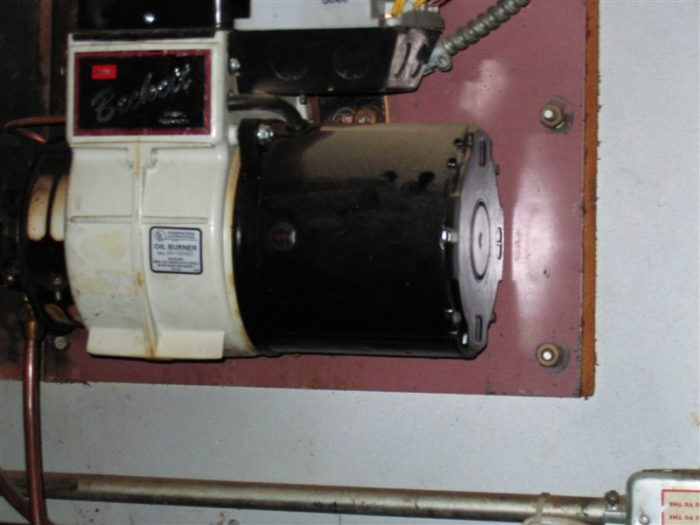

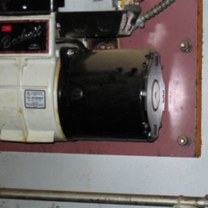

            This is the oil burner, I emailed the company and they said it was made in April of 1991.

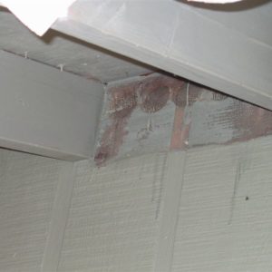

            This is some of the mold beside the furnace. You can seem some discoloration from the improperly installed furance too.

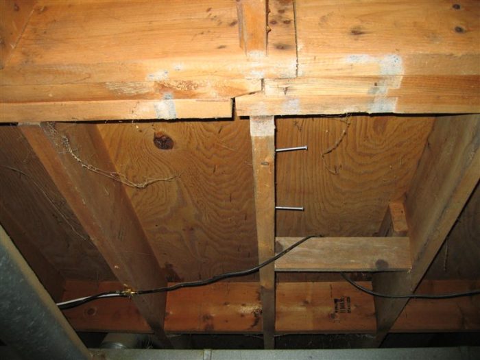

          5. frammer52 | Mar 28, 2009 04:00am | #47
            I read the engeneers report and the only thing he was worried about was the unsupported beam.
            That can be repaired as he stated as long as there has been no settling.

      2. frammer52 | Mar 28, 2009 03:45am | #45
        You did not see the improper shingle instllation?
        How about the lack of joist hangers?

    Can you elaborate on "three tab shingles aren't installed properly"?

      The exact words the inspector used were: "The 3 tab asphalt shingles were not installed on a 6 inch bond", I think this picture shows it well.

          There is some mold in the roof decking (seen from the attic), and on the floor framing in the basement just in one spot by the furance, but I think it can be remedied by scraping/sanding/removing the mold, and then alleviating the moisture.

          1. back2work | Mar 28, 2009 05:10am | #53
            Josh - Got anymore info on this pick? What are we looking at here - addition?11_Improper_soil_cut_x2.jpg
            84KBI think I see where the old/off fall shingles went -
            Edited 3/27/2009 10:20 pm ET by back2work
          2. JoshRountree | Mar 28, 2009 05:18am | #54
            No, that is a step in the footing. The ground slopes outside that wall. Here's some more pictures of it.
          3. back2work | Mar 28, 2009 05:25am | #55
            I'm talking more about the framing above that - is that a 3/4" ply sill plate, or am I seeing things?Maybe it's a shelf.
            Edited 3/27/2009 10:28 pm ET by back2work
          4. JoshRountree | Mar 28, 2009 05:39am | #56
            haha, That's part of some old shelving and peg board down there. Apparently (this is from the seller's realtor), the owner before the people who own it now worked for some type of contractor or somehow ended up with a whole bunch of scrap building materials and stored them down there in the dug out basement. It was also like a workshop, there is coax cable ran everywhere, speaker wires, weird shop lights hung up, a drain pipe for a washer that drains somewhere, but not connected to the waste pipe.
            Haha, I haven't even told ya'll about the outbuilding. It's pretty scary inside, very weird...

            Furnace, don't even bother running it, unless it's already pretty warm - just get it replaced with something new.  TIP:  When shopping for HVAC installer, ask to see a previous residential installation.  That saved me from going with a company that did shoddy work.  In HVAC, installation is everything.

            I plan on removing the furnace and oil tank first thing before I start foundation work.
