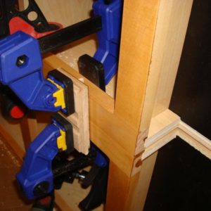

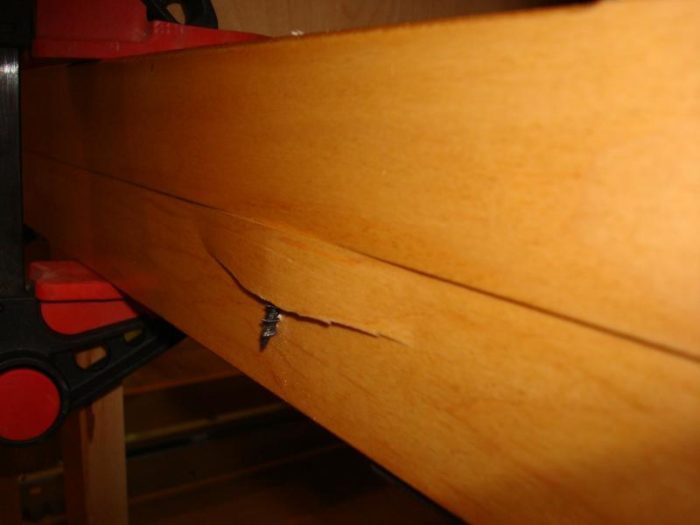

any suggestions on repairing the face frame blowout? Considered glueing up the solution in the second photo but then I figure I’ll just end up with a scrap of hardwood floor glued to the face frames.

    Good lord, those screws are gigantic!  They look like post-hole augers!
    Oh - wait - that's just a big .jpg.
    Um - Since the finish is already on, I'll bet glue-squeeze out would clean up quickly.  I'd glue and clamp the original wood back with a sheet of waxed paper or poly between it and the clamp block.

    Well, when I clamp something like that I always place a couple of layers of wax paper between the clamp block and the workpiece. Probably better still would be a sheet of release paper.
    (You would, of course, have to sand and refinish after gluing, regardless.)

    My way would have started with "blowing" wood glue into the split then removing the screw. Clamp for 2 hours before removing the clamp.
    Next time drill a 1/8" hole as deep as the screw will be. Follow with 3/16 to the width of one style. Install the screw. Maybe lube the screw with soap or wax.

    Shoot in glue, tickle glue in with a toothpick, remove screw, wipe off excess, clamp, maybe with a block and wax paper -- see how it goes.
    Hey, that looks like a piffin screw.......
    Full depth pilot, clearance hole through 1st stile, beeswax on threads.

    squirt glue in, remove screw ... hold block and smack it flat.
    wipe ... wait ... wax stick.
    move on ...

    Aside from all the things you did wrong.......when you run in the screws you do it slowly with a finger or two on the area where the screw might blow out. You feel a bulge coming on you back up quick.
