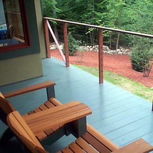

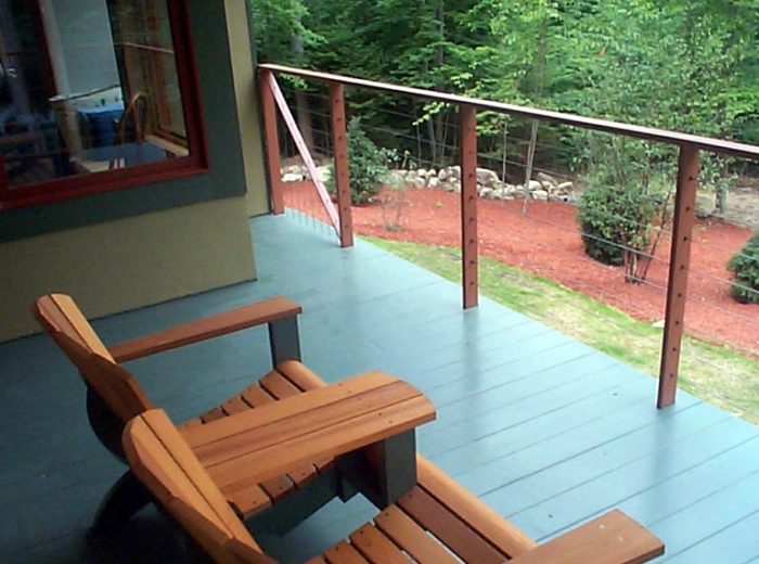

  2. stinger | Nov 10, 2005 04:17am | #2
    No code enforcement here where I am, at least as far as railings go.  Here's mine.  Used Cable-Rail, had a local weld shop make the frame from 1x3x1/8-wall steel tube.
