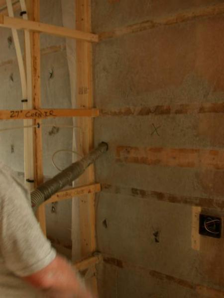

I have a hard time dense-packing cellulose very quickly, and am wondering if I’m slow, or if it’s just a slow process. Using regalwall insulmesh and a force2 blower, I have a hard time packing in more than about 40 bags a day. Seems there are always tricky spots and things that slow me down, and whenever I try to up the feed rate, I can’t get as good a pack and have more clogs.
So how fast are you able to dense-pack? And what kind of density are you able to achieve?

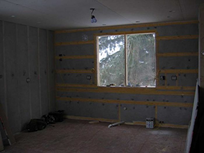

Rich,So how quickly and how densely can you get it in the walls with that blower?Here is a picture of the recent mesh job I just did. I get much better density with the mesh than behind solid walls. I think this was up near 5lbs/cu ft.Steve
No way you can get 5 pcf, especially with an open wall blow. You would have blown the insulweb right off the studs long before you reached that density and I don't think there's a machine out there that can achieve such densities.

Robert,I know. I was stunned when I did the claculations. I did them over and over again, counting for every piece of framing, etc. I was getting better than 4 lbs no matter how I sliced it. And in the biggest, easiest to calculate volumes, it was over 4.5 lbs. And I have to say, it was dense. I had to really beat on the mesh hard to get it back to where I could install the sheetrock.The absolute tightest I've ever gotten it in the past was 3.5 lbs.Steve
How far does the mesh bulge beyond the framing ?
carpenter in transition
tim,It depends on how tight you pull the mesh when you install it, and how far apart the studs are, but generally about 3/4" in the middle.Steve
I haven't used insulweb, but I spoke with a technical consultant at National Fiber a couple of days ago and he suggested stapling the mesh to the sides of the studs after stapling to the inside edges, in order to pull it tighter and to prevent bulging.
