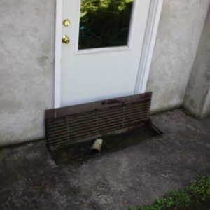

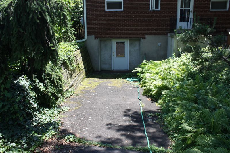

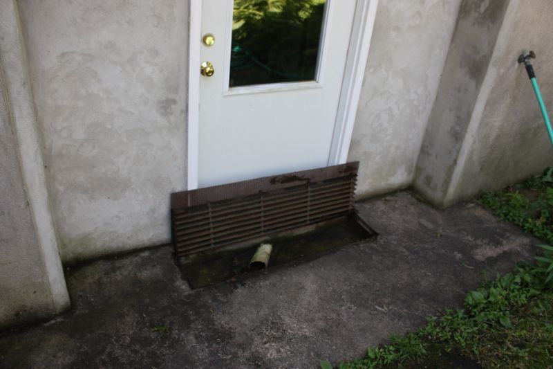

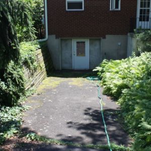

I need advice on how to do this project right-according to today’s best practices. I have a driveway (10 ft wide x 27’ long) that slopes toward the house at a slope of 7 degrees, that’s roughly 1 ½” rise per foot of run. Needless to say, when it rains, I have a good amount of water running at the house. At the bottom of this driveway, at the foot of the door, there is a drain (see photo). This drain has PVC pipe inside it that drains to my sump pump in the basement. The sump needs two pumps, one of which is battery backed up and can run continuously for 7.5 hours if the power goes out. By the way this drain at the foot of the door is below grade by about 6 feet and I don’t have any ability to run it to daylight somewhere.
I want to remove that door and block up that wall as if it were a continuous foundation wall. Then I will apply waterproofing to the outside of this wall. Then once that’s done,  I  will remove the asphalt , remove the railroad tie retaining wall,  back fill with clean fill dirt, and then grade so that the fill slopes away from the house. Basically I am removing the driveway. Tamping and rolling the dirt layer by layer.

  1. How do I deal with the existing drain at the foot of the door? Do I completely fill it with concrete prior to back filling? (if I don’t get to back filling, after sealing it off and it rains, I may have a swimming pool on my hands).
  2. OR Do I leave the drain and replace it with, say, a length of perforated drain pipe to handle any water that may reach that area after the back fill is placed over it?

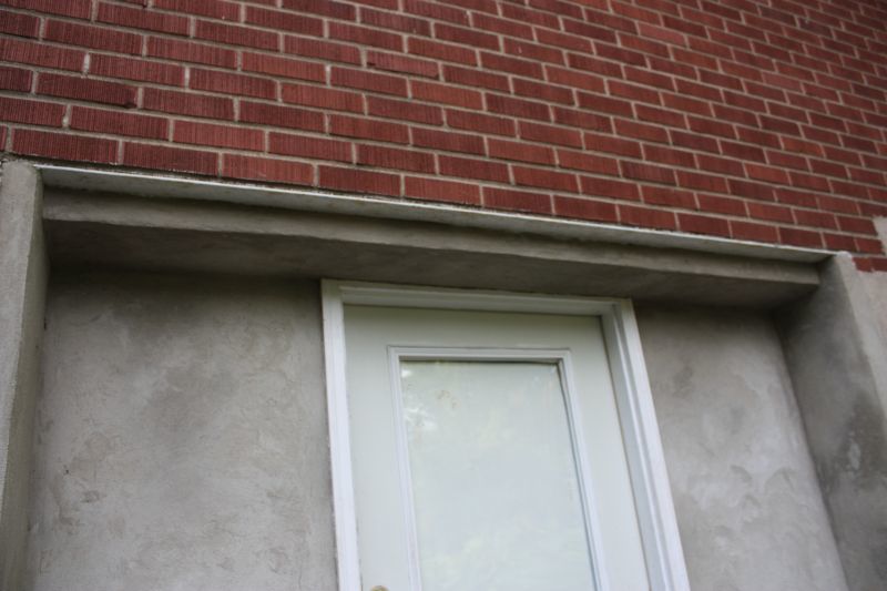

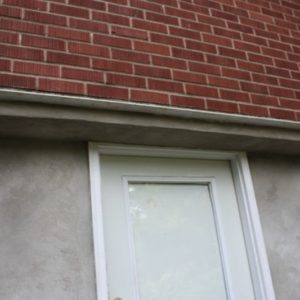

  6. When I get to the top of the wall with the new block how should I finish it off near the sill plate?
    There is a steel angle above the current door/old garage door at the lintel. Ideally how do you let this new block wall support the wall above?
