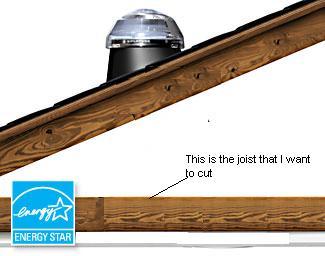

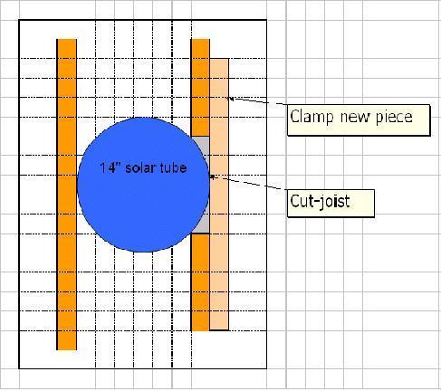

Hello, I am planning to install 14″ solar tube, the joist is 14″ center, the rafter is 24″ center.  I want to install the tube straight but the rafter is on the way, and because the height from the ceiling to the roof is only 18″ plus the height of the flash is 10″, even I try to twist the tube, I can’t make it.  So if I can cut this joist, see pic.   Thanks.

  2. Piffin | Jun 29, 2009 06:17am | #2
    Sure, but use glue and structural screws instead of clamping the sister.

    No. You aren't resupporting that the right way.
    Yes, but that would be considered boogering. I can guide you in this procedure but I'd need to know more.
      IMERC | Jun 29, 2009 06:22am | #4
      just tell him to put in an off set or header it...

    That's not a pier. It's a light tunnel
    1. mikeroop | Jun 29, 2009 07:00am | #9
      you are so right. and more awake than I  :) thanks and good night.

    Make the sistered piece overlap the cut joist at least two feet on each side of the gap.
    Use polyurethane glue and four 5/16"x 4" hex bolts on each side of the cut. Use thrust washers on both sides of the bolts, too, to prevent the head and nut crushing into the wood as you tighten it down.
    Set the four bolts in a staggered pattern so that no two bolts are the same distance from any edge.
    Note: If you've never used polyurethane glue before, you need to wipe down the wood with a damp cloth before you spread the glue on. This type of glue cures by reacting with water, so the wood needs to be damp. The glue will start foaming within a few minutes, so once you've got the glue spread, assemble the joint right away and clamp down on the bolts.
    Don't try to wipe off any foaming glue that squeezes out of the joint; wait a few hours till it's dry then trim the cured foam with a razor knife if it's in your way.

      Piffin, I meant clamp a new  piece overlap as the pic then use screws to hold them.  Thanks Dinosaur with a detail iView Imagenstruction.

      So granted that there are many roads to Socialism, Premier Khrushchev...I'm curious why Gorilla glue and bolts as opposed to PL and 3" screws or sistering the joists to either side and then capping the severed joist with a single/double header? (guessing the one side is close enough to the eave to use just a single on that tail)Inquiring minds and all that.'Man who say it cannot be done should not interrupt man doing it' ~ Chinese proverb
        Dam_inspector | Jun 29, 2009 04:24pm | #18
        Wonder how they did it in the olden days, before Gorilla glue. I've pretty much banished that stuff because of problems unrelated to glue bonds. Like glued hair, black spots on my hands and whatever else, glued clothes, glue foam out, short open bottle life, etc.Id just spike on a 8' splice most likely.

        Actually I don't use Gorilla¯ brand glue; I usually buy PL liquid P-U. Doesn't matter much; the point was to use a structurally-rated goop of some sort and polyurethane glue meets that standard.
        I like thru-bolts and thrust washers better than screws for this sort of thing as the likelihood of stripping out the wood is nil with a bolt, while it's fairly high using screws now that ev'rybody and his maiden Aunt Millie has a 24-volt LiOn impact gun. Didn't matter so much in the old days when ya had to pre-drill and wax yer slot-heads, then drive 'em down by hand....

  6. marv | Jun 29, 2009 03:52pm | #17
    Very improtant before you cut...do you have trusses in the attic?
    You get out of life what you put into it......minus taxes.
    Marv
    1. Piffin | Jun 29, 2009 05:08pm | #19
      Not likely with a description of rafters at 24" and joists at 14"

        1. Piffin | Jun 29, 2009 06:53pm | #22
          Yesbut there are a half dozen variables here that could apply to this answer. Short and sweet is just do it.Like how long is this joist and what load does it carry.
          If carrying a storage area as well as the ceiling and insulation, maybe it should be double sistered and headered instead.how good of lumber is it?is he using screws ( what kind) and or nails?Is there strapping in this ceiling?unless this is terribly unigue, just gitterdun

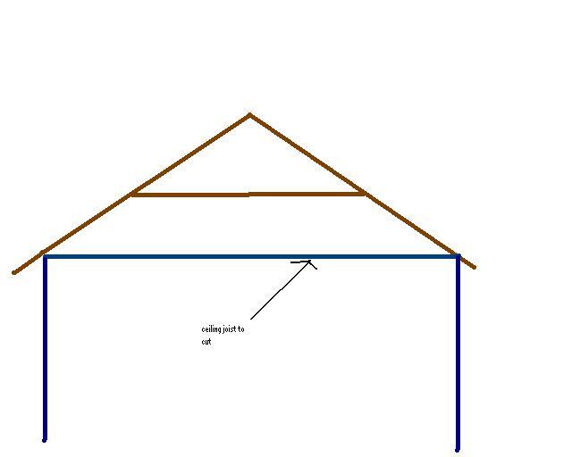

    2. vincent843 | Jun 30, 2009 12:29am | #27
      No, I have 16 ceiling joist on this family room, none of the rafter is pair with it as I see in new home build.  As the joists are 14" center, and the rafters are 24 in, they're barely meet...  The rafters have their own joist  near on the top....
      Edited 6/29/2009 5:30 pm ET by vincent843
      1. JTC1 | Jul 01, 2009 12:15am | #33
        >>The rafters have their own joist  near on the top....<<
        Those would be collar ties.

  7. Jed42 | Jun 30, 2009 08:07am | #31
    I second this...
    Pesky 'ol framing holding the house up!  What were they thinking putting that there?
    If it's conventional framing, you should head it off instead of sistering something next to it.  Will the sister work?  Probly for a while.  I'd spend the time to head it, though.
    I'm pretty sure you don't want to cut a truss.
