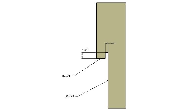

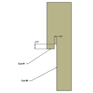

    I have made lots of door jambs and have always just used a standard 1/8" kerf blade. In fact, I just incorporate the slot in the cut that I make for the rabbet. There are really only two cuts to profile a door jamb; I can usually have a door ready to install in about 1-1/2 hours.
    If you save the rabbet off cuts, they end up being the perfect width to space the door away from the stops during assembly.

        1/8"........5/32".......9/64"........ et al.You will run into variances here and there both in the blades in your saw and the fit of the different weatherstrips on the market. On top of that wood moves, shrinks, swells. What's my point? I think you are over thinking this all. Make a test piece; you will want one handy if you ever decide to make another door jamb anyway. Make it long enough to incorporate the head dado, the upper hinge mortise, and still have room for the threshold dado. Make it out of the same wood you are using or something more stable. Make sure it is perfect and square. Then use it as a gauge for setting up your saw. I have interior and exterior test pieces that I made or chopped out of old jambs that I use as set-up blocks. I put notes and dimensions right on them and I can test fit weather strips and thresholds on them.remember: carpentry ≠ rocket scienceDC
