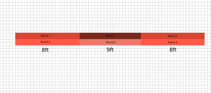

Hello, I am building wooden beams out of 2×10’s for a house. I was wondering if they could be constructed this way or if there has to be one long beam when two 2×10’s are attached to each other. Thank you. See example below (I only placed two together in the image but in reality 3 will be placed together).

    Are you connecting the 2x10s end-to-end? If so, how do you propose to do that?
    Are you trying to span 25 feet (8'+9'+8')?
    There's not enough information provided to properly respond to your question.
    unclemike42 | Jun 01, 2022 05:55am | #2
    Could you mark on your drawing where the beam supporting locations are?
    As drawn, you have three beams end to end, not a single beam.
  3. ketchgould | Jun 01, 2022 09:42am | #3
    That won't work. You would need to overlap joints and scarfing the joints over a long run would help too.
  4. florida | Jun 01, 2022 01:51pm | #4
    That would work as long as you have piers or support columns under the joints.
  5. kerazy | Jun 02, 2022 07:59am | #5
    Not enough info. Beam would need post/columns beneath joints.

    ct_yankee | Jun 10, 2023 03:58pm | #7
    Sometimes even a crude picture isn't enough.
    We are forced to assume that the 2x10s are used on edge (side-by-side) and NOT stacked.
    If you are supporting your triple 2x10 beam at the 0 ft, 8 ft, 17 ft & 25 ft locations, you will be fine, assuming that they have been properly checked for strength & deflection.
    unclemike42 | Jun 10, 2023 04:46pm | #8
    Design of any beam or other structural member really needs to start with the rest of the house and an evaluation of where this beam fits.
    All the loads it will carry need to be understood, as well as how they transfer to the beam, how the beam will carry loads from sides and above over a span between supporting points, and from there down to the foundation.
    Beams can be engineered or built up from separately specified materials.
    The grade, size, species of lumber need to be taken into account, as do the specific design capabilities of any other materials used, including nails, screws, plates or framing connectors.
