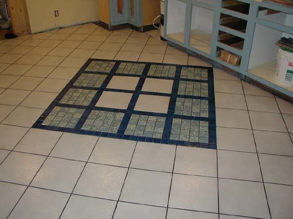

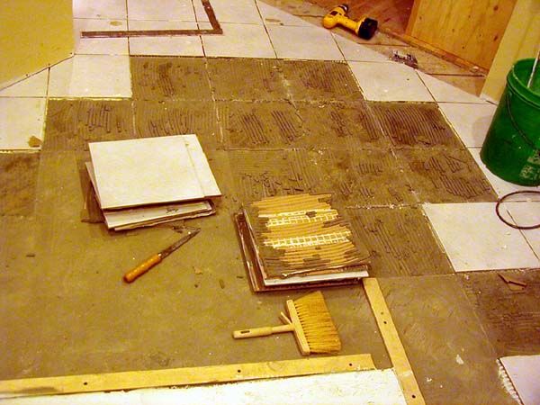

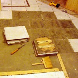

    I've put down slate over both cement backer and ply, but i had failure over ply when i used a brand other than Mapei. (See first photo, using Versabond thinset from HD with ceramic tiles.) Most of the mortar came up with the tile, but it could be peeled off pretty easily from both surfaces the second day. I could pull up any tile with my fingertips.
    The Mapei thinset is used to re-lay the floor worked perfectly,and it's been walked on for two years. I also used Mapei over ply with slate recently. Though it hasn't been down long, i checked for looseness before grouting and there was none at all. I had the same subfloor and ply as you in both instances.

      LEMONJELLO | Jan 11, 2007 11:53am | #21
      Hey there,
      Looks a lot like you had a mess there.Couple things:
      -It looks like your thinset was too dry (stiff). Just looking at how the tiles/floor/thinset separated-The tile and floor suck moisture right out of the thinset further creating a weak bond.
      -Hot tiles that have been in the sun can "cook off" (dry out and not bond to thinset) too fast when setting. Spay or dunk smaller tiles with water.
      -I usually dunk 4 1/4 x4 1/4" ceramic tiles in a bucket for a few minutes .
      -The acrylic modified thinsets have better adhesion under these conditions, but right consistiency is important.
      -Acrylics have more flex and for ply substrates.
      -Acrylics bond to underlayment membranes.This might sound wierd but I discovered this as a kid....
      Touch you tongue to the back of a ceramic 4x4/ 6x6 tile for a few seconds and you can feel it suck the moisture out of tongue.
      (no, it's not just to see how many people will try it. Seriously)

      1. splintergroupie | Jan 12, 2007 12:31am | #24
        Thanks for the ideas. I'd asked for advice on bonding agents before (not here) and it was conflicting so i opted not to use it, but i will rethink my position on that in case too mush water is being sucked out of the thinset. For the other... I had a similar non-adhesion problem one other time 12 years ago when laying my very first slate over ply, using a thinset from the Quikrete family that time, with a latex admixture. I remedied that problem using a different mortar called "Spec Mix" that i got at a masonry supplier instead of the hardware store. Fortunately, that was a small bathroom job. Unfortunately, the Spec Mix wasn't available when i needed to lay the kitchen job in the photo, so i went to our new HD and picked up their Versabond. The Quikrete and the Versabond felt different to me from the Mapei, like the difference between working with pie dough or bread dough, if you will. I could crumble the leftover dried Quikrete and Versabond in my hands, while the leftover Spec Mix and Mapei thinset dried like a rock.I would have thought it a mixing problem, dry tiles (it was winter, our driest season in MT indoors), pilot error, or bonding agent issue except that i just last month used the Mapei over ply, no bonding agent, with slate...and the slates wouldn't budge after only a short time in place. The only significant difference seems to be the brand of thinset.I always sand, sweep, vacuum, then mop my plywood before laying tile or slate. With the tile, it's certainly possible that having been laid once, then pulled up, the tiles and ply had more moisture in them when they were laid a couple days later in the Mapei thinset, but i wouldn't think that would be much of a factor in the earlier slate problem, slate being less porous.Anyway, i'm "sticking with" Mapei! <groan>
          LEMONJELLO | Jan 12, 2007 03:21pm | #25
          It's a good product. I've used it often too.
          Sounds like you did great surface prep, sometimes ship happens!
          I get your point on material consistiency, each brand and type are different.
          To me some feel like peanut butter, some like frosting, others are goey.__________________________

    People used to install directly on ply for many years.  It's not current practice, but it was done successfully in the past.
    I wonder if part of Splinties problem was that the first time she laid the tile, the ply sucked too much moisture out of the thinset.  And that's why some folks here are suggesting a bonding agent.
      EricPaulson | Jan 11, 2007 03:18am | #19
      I think she used a poor quality thinset.
      Giving the plywood a thorough cleaning is a must to me. Sweep, vacuum, sponge. Even to the point of it being wet.
      Applying bonder takes another 30 minutes. It's a no brainer. Cheap insurance too.[email protected]
